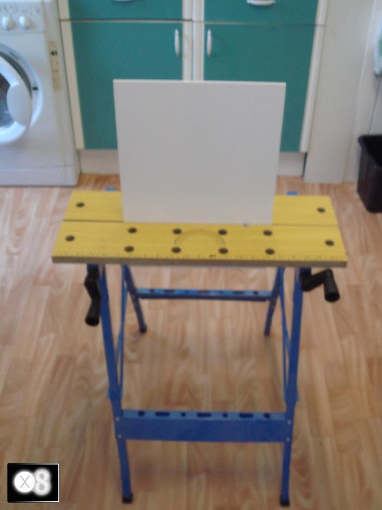

When I bend plastic I use a work bench. That way you know the edge is going to be straight. Take your time, because if it's not heated evenly then it will ripple.

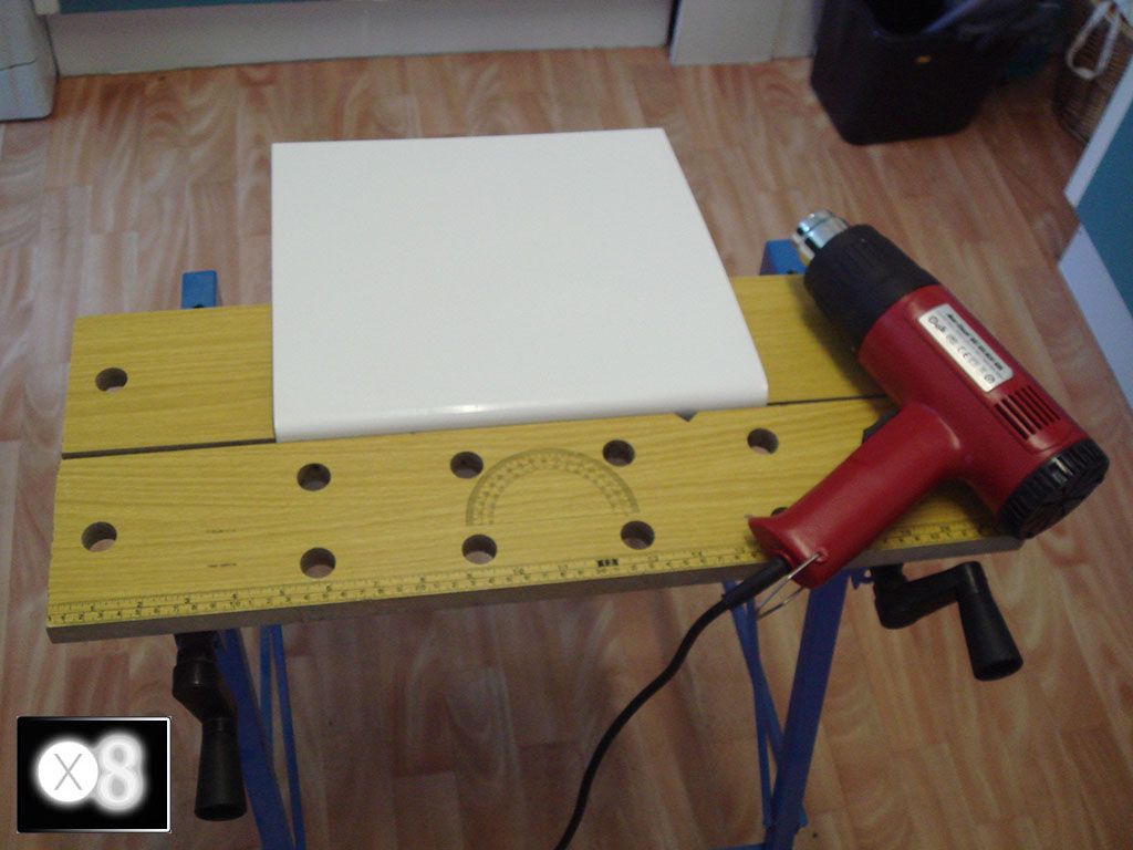

I set mine up like this.

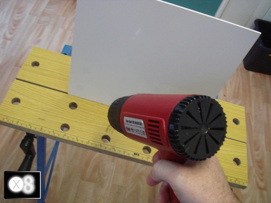

Then heat for a while.
Then bend. Now I usually wear oven gloves when doing this.

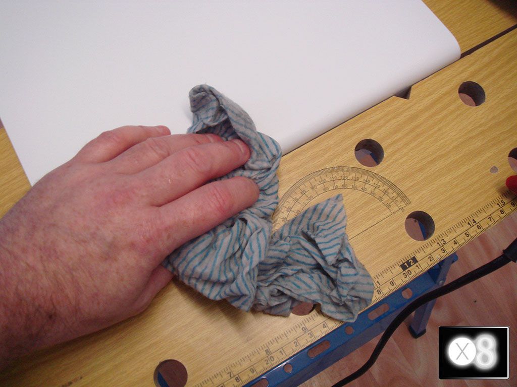

The big trick (and to prevent ripples) is to keep pressure on the bend until it has cooled down. Then, when it's starting to set take a damp cloth (damp with cold water) and apply even pressure to get it cooled down and set properly.
