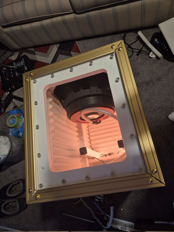

OK so it is now finished. After lugging it here I got to work fitting the deadening inside.
Badges and lights fitted.
Round to the back for the terminals and rear plate.
Finish up the power wire and connector on the DSP/EQ
Fit new sockets and trunk wires etc.
It is on a breaker. The very next day it tripped when my hot water heater blew up ffs. That could have taken out all of the electronics. Glad I went with protection tbh !
And complete.
I did not think the light would come out of the port also, but I love it :D
And then wall mount the DSP, finish the ex speaker stand, connect amp etc etc
And...
So how does it sound? jesus. Scary lmfao. Someone said on another thread that it was not a subwoofer, merely a woofer. Incapable of reaching down low. Oh how very wrong they were. In fact it is better sounding that my old 15" sub. Mostly for the reason that I have what was once a 1200 quid amp on it and a DSP that for the 50 quid or so it cost is criminally capable. It was pee easy to tune, and then EQ for even more thundering bass.

I really like how it turned out. Looks retro, but modern at the same time if that makes any sense lol. I feel like it could transform and walk away. Sucks about the water heater, but at least now you can bump this and annoy the neighbors!
