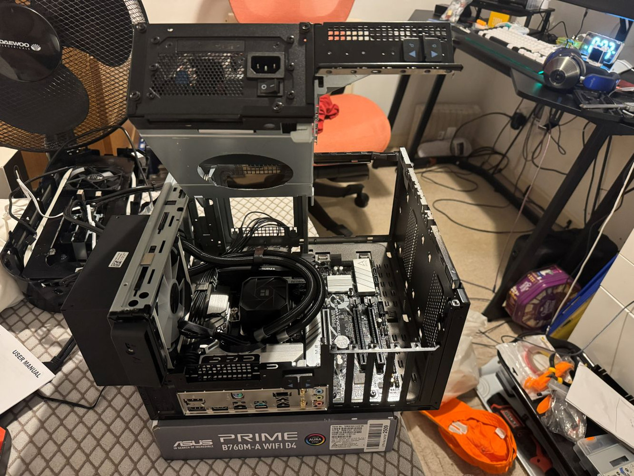

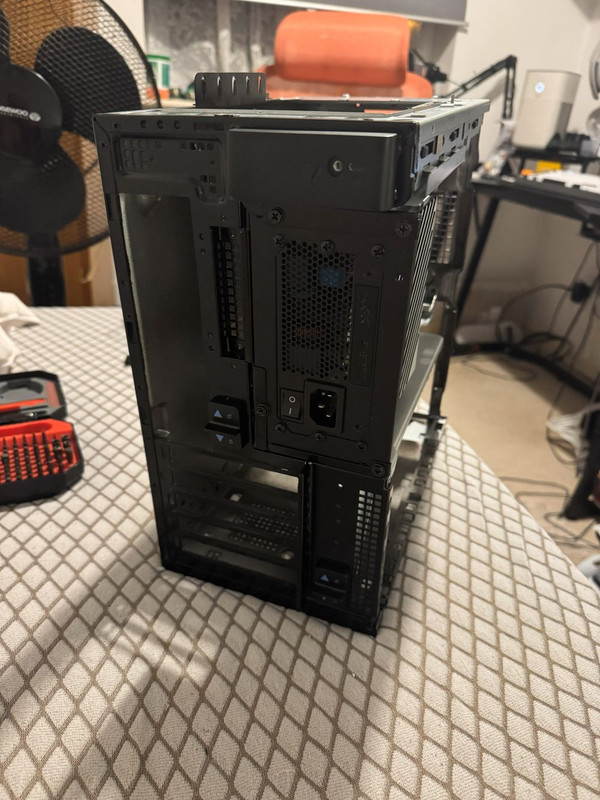

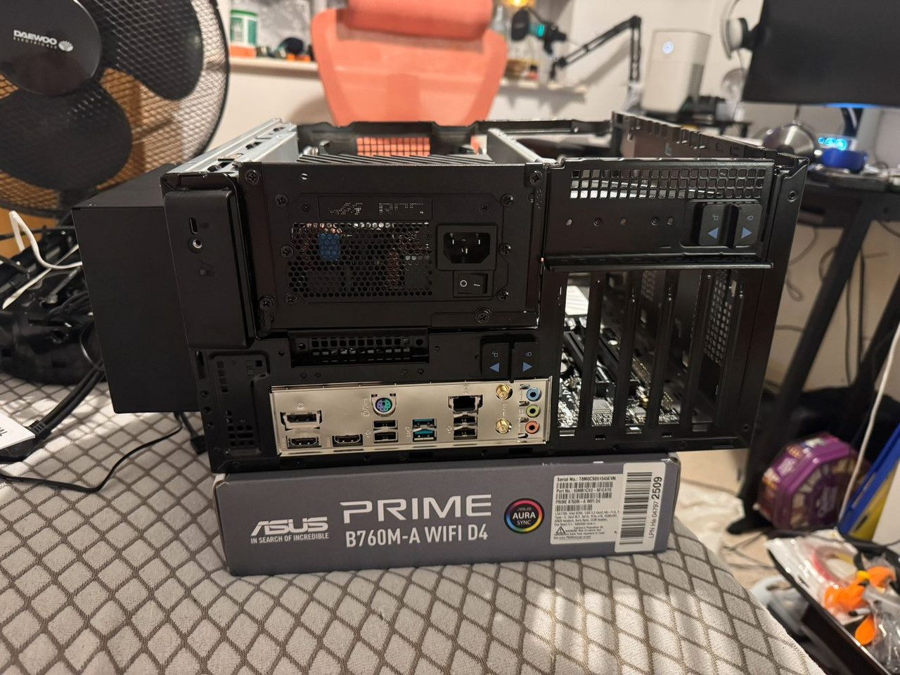

Any way, given how "nice" Dell had been for many years I figured this would be a simple case swap. Seems I was completely wrong ! The first thing I realised is that the IO shield is not removable.

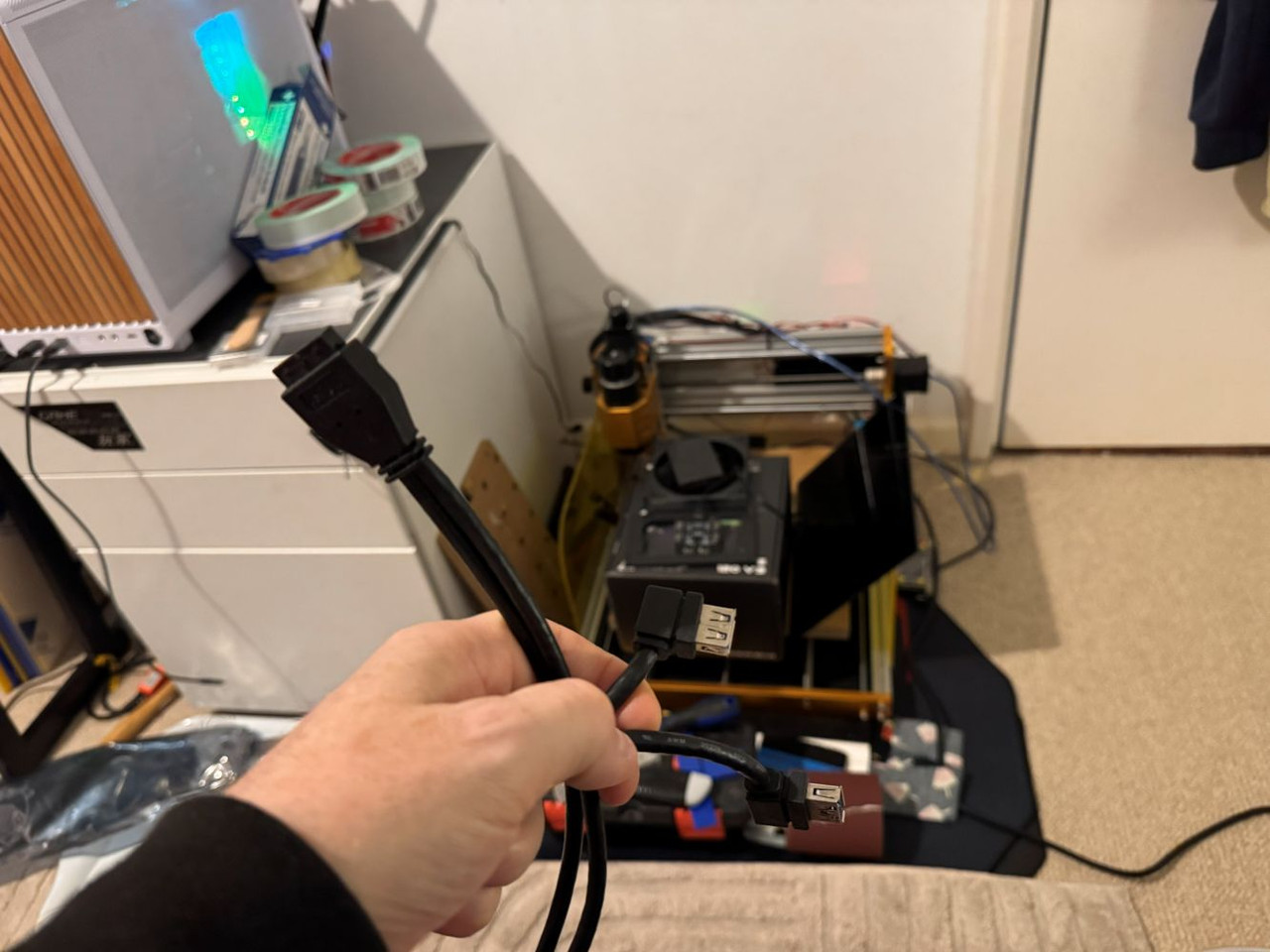

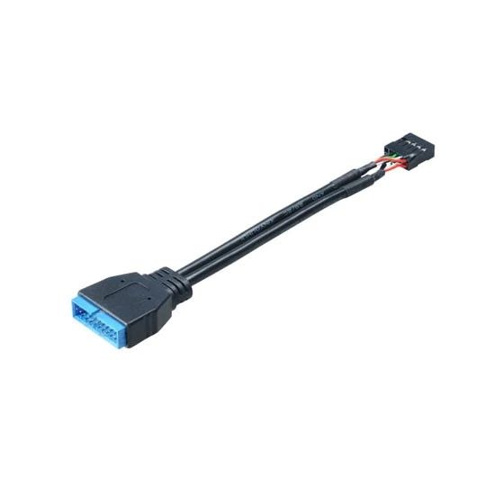

Which is kinda Apple like but look we can deal with that. They even left us a nice template to cut out. However, this was when I started to notice oddities. First up there are two USB 3 connectors.
OK not a problem I can get around that by using this.

Any way so the devolution of Alienware aside.... I have never had an IO shield on my X570i Strix. I bought it as a bare board only customer return for about 1/3 the RRP at the time. I finally found the IO I need on Ali, years later.

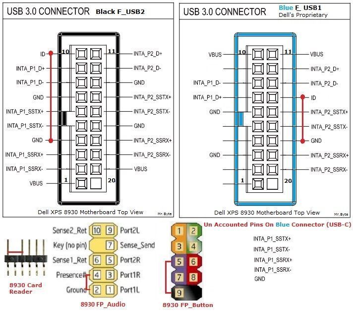

OK. So the front panel is not standard.

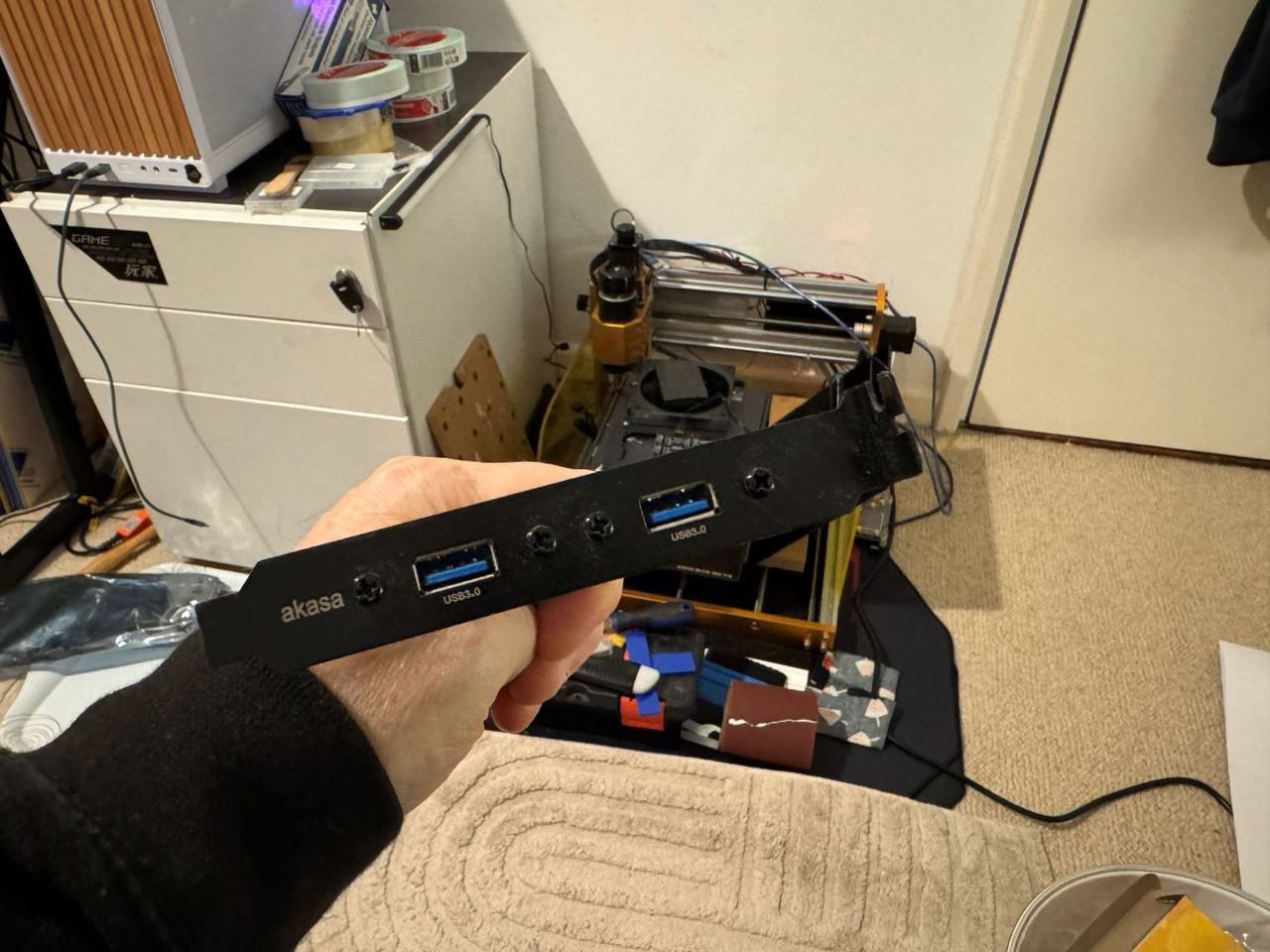

The black one is (it is USB 2) the blue one is not. So I ordered this.
And will graft in these for the 3.0
Or these.

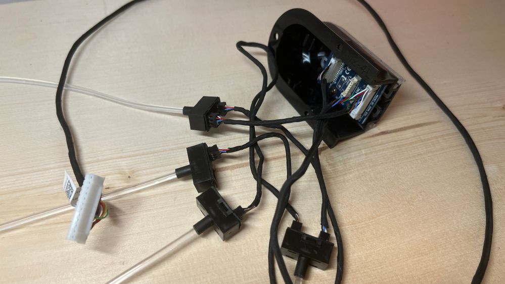

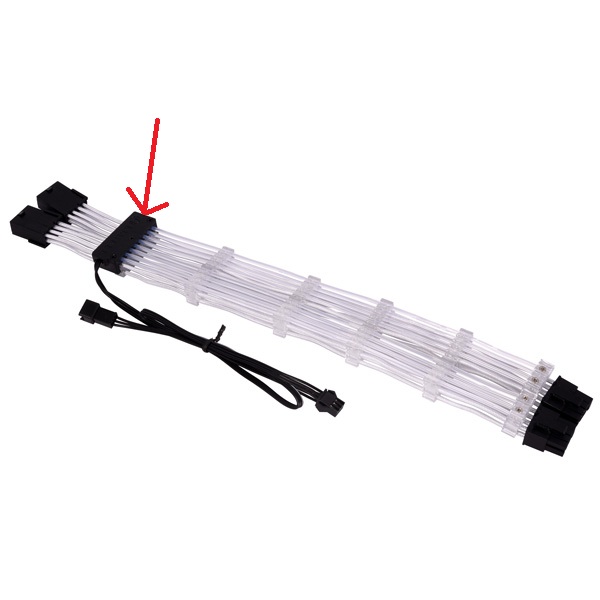

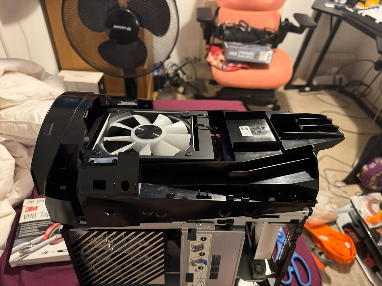

OK so another discovery. The front RGB uses light pipes.
Edit. The panel for the ALIENWARE text also uses those "tron lights" as Alienware call them. It is in the service manual.
Now this took some head scratching. It seems they share the same working principle as Lian Li Strimer V1. IE plastic tubes with a single LED projecting along each one.
So I am going to have to make my own. The black boxes can be 3d printed by a friend of mine, I will then fit these.
I might even CNC some tiny circuit boards to keep things tidy. For the main panel? I will use RGB strips. Plenty of room there.

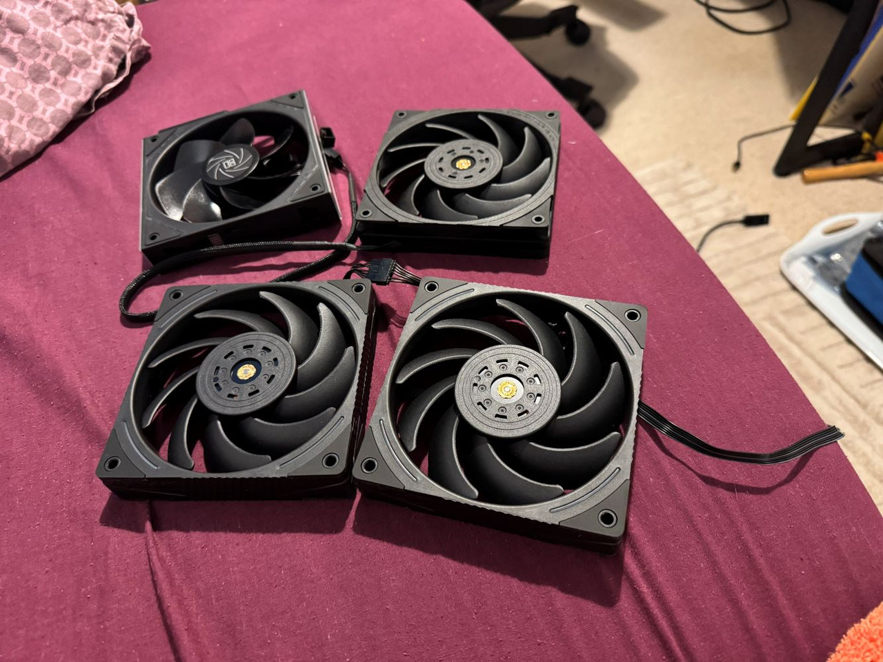

So the fans are sorted. For free too which is always nice !
It did catch me off guard though. Like, two of them are wired together and have a RGB connector. I couldn't make head nor tail of it then I realised they must have come with one of the AIOs I bought (probably the one recently I put in the 5090 build) and they do indeed have RGB. Tiny weeny bits.
So the bottom two are the RGB ones. They are all identical, though. Basically I read (I think it was Der8auer who said it) that they are exactly the same as EK Vardar fans. Made in the same place and everything. I then have another one which will be fitted to the side panel where the GPU vent is, and a reverse flow RGB fan for the AIO which will be the pull fan and be visible through the roof vents. The two RGB ones are going to be the intakes in the front, and there is already one of the plain non RGB ones fitted to the cooler (I did that earlier).
So yeah, these fans are pretty butch so I don't see them having problems bringing in air.

how many wires go to them LED's? I am guessing the plug that goes to the motherboard is just a link and power to that smaller board where all the LED's connect to/get power and signal from. I am also guessing that they are RGB LED's or RGBWW/RGBCW.
If thats the case just get a LED drive for them and do away with all that other stuff that's not really needed

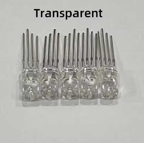

I am pretty sure the LEDs are 12v. They are only controllable on the Alienware app by zones. I don't want them 12v. I want to be able to run Asus's "Starry night" which is amazing. As such? I may as well just replace them all tbh.

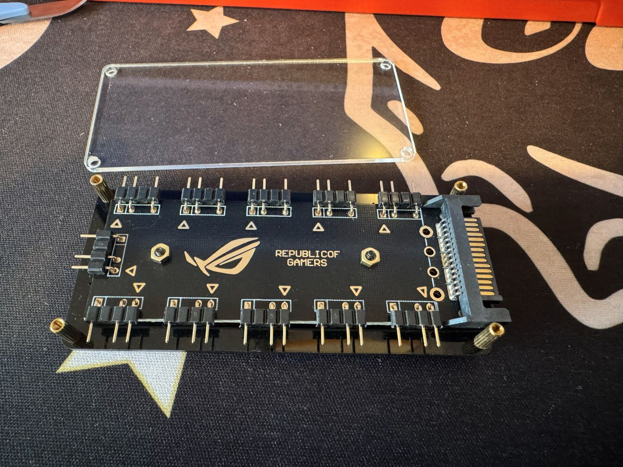

The only difficult part (if you could even call it that) is this -
I may need to get some of those little holders that hold in the bulb and light bar thing printed. Thankfully I know a guy who can do that. I am also going to buy some copper coated fibrelgass and make some PCBs. Tiny ones, but my CNC machine is more than capable. This will help with my failing eyesight and give me pads to solder onto lmao. Nice thing is once I have gone through that it will all just be 3 pin connectors that will connect into this.
And then I can just use Armory crate. Far easier tbh !

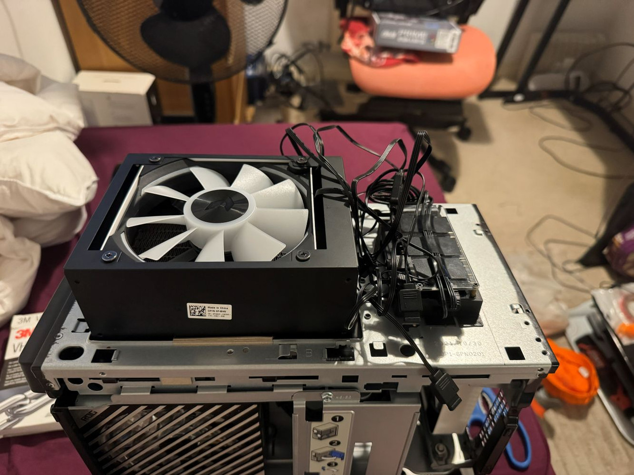

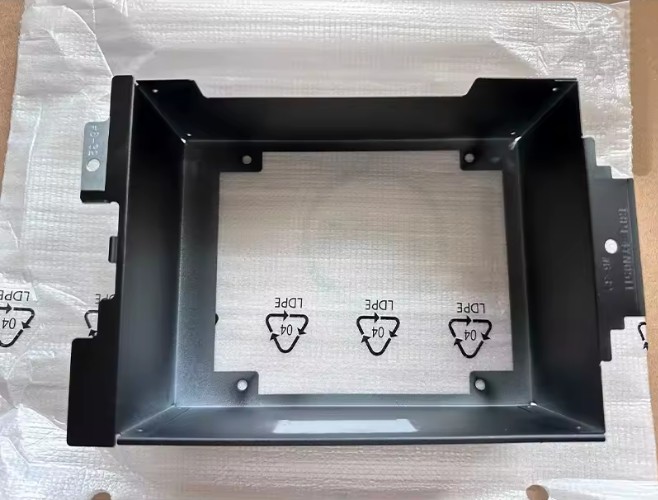

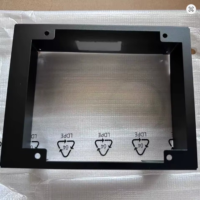

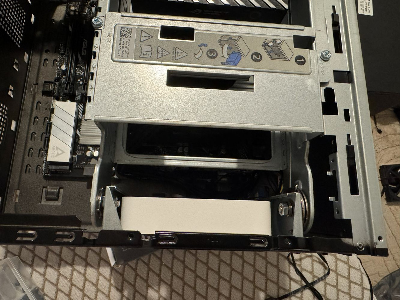

One other thing absent. There is no rad carrier ffs. Seems if you do not pay a ton for their 120mm AIO the case does not include the holder. See here at the top in the roof at the back.
I spent 3 days trying to identify that sodding thing. If I could get one it would save me a F ton of aggro trying to build something myself to hold in the rad and fans. In the end? Aliexpress saves the day again.
£15 delivered.
