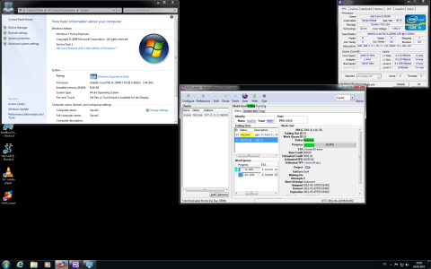

Going from pure processor folding @59000 ppd to GPU(680) + CPU(3930k@4.5k) folding gave me 63000 PPD.. is it just me or does this not seem worth the added power-draw?
Also server (2500k @4.4) with GPU(7970) @28-30k, turning off GPU= 45K..
Both of these GPUs will probably run the FahCore_16, which is pretty CPU intensive, try clearing 1 core(2 threads) for the GPU folding and see if the PPD goes up. Not sure if this will work properly on the 2500K as I think you can only select 2,4,6,8 cores for SMP folding in the latest v7 client. Can't try this as I am still stuck on a e6400
