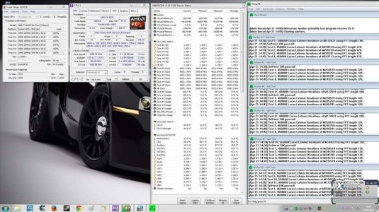

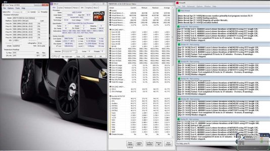

I have been checking up on OCing and have clocked my cpu to 4.0mhz and wondered if some could have a look at the reading as I was thinking I could either bring the core voltage down or clock a bit higher but being a novice a bit worried I could screw up.
I also was wondering if the temp of the Auxilary matters as at idle it runs around 84 degrees and under load 17 degrees.
I have included some screen shots but for some reason cant get them to show right if some could resize would be most apprciated.

As Barnsley's said could you host your pictures externally they are very hard to view, if what I can see is right 1.425v at 3999.8Mhz, you should be able to get the 6300 up to 4.0Ghz quite easily and stable with just 1.33v. They are pretty good chips for clocking compared to the earlier 6100 & 6200s.

Should be able to do 4.4Ghz under around 1.38v ~ 1.4v, maybe 4.6Ghz if it's a good chip. Just the ballpark you should aim for.
