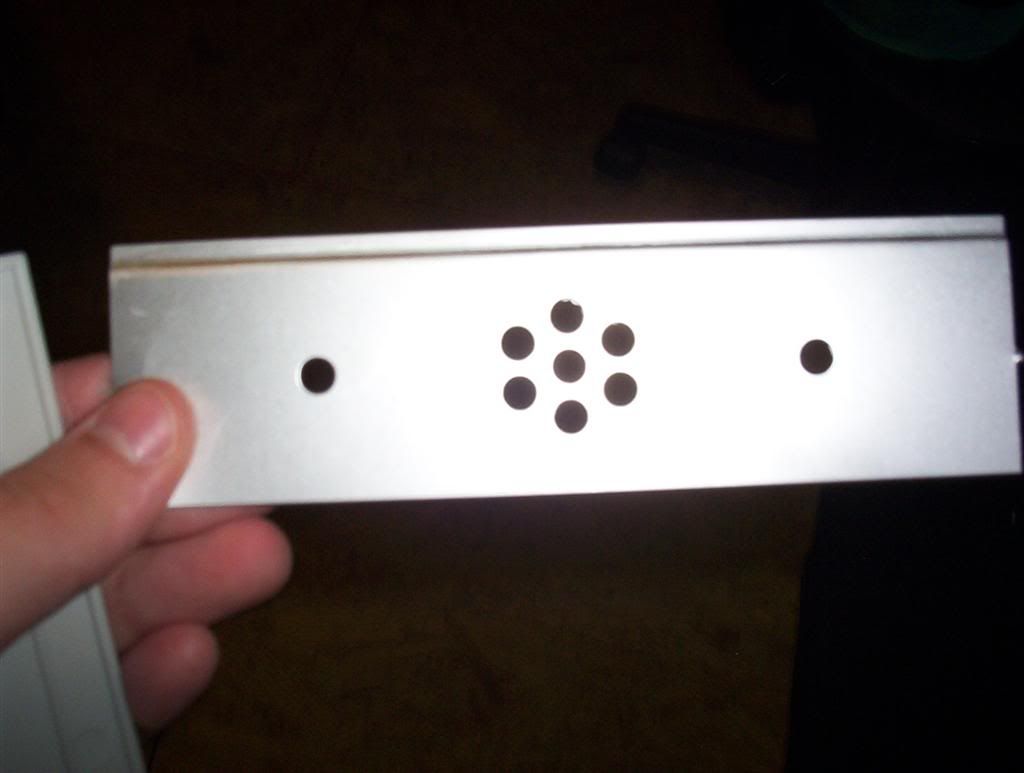

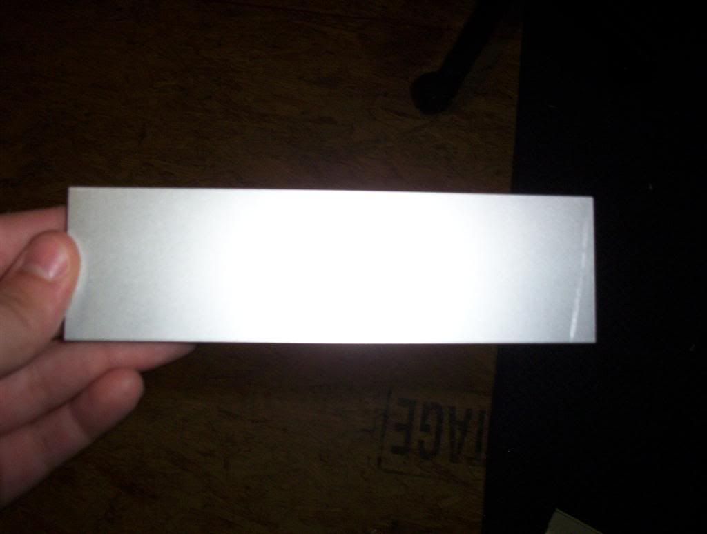

First, prepare your bezel type thingy.
--Find a suitable pattern, and a drive-bay cover.
That, was actually one of the metal things you have to snap out of your CD ROM bays, so you can get a CD-Rom in. Came out of my LanBoy.
One of my Bezel's.

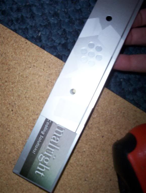

Tape it on and drill away.
My dad's Black & Decker Firestorm Cordless Drill handled this with ease on Speed mode. Not sure if your drill's have speed or torque mode, set it on personal preference I guess.

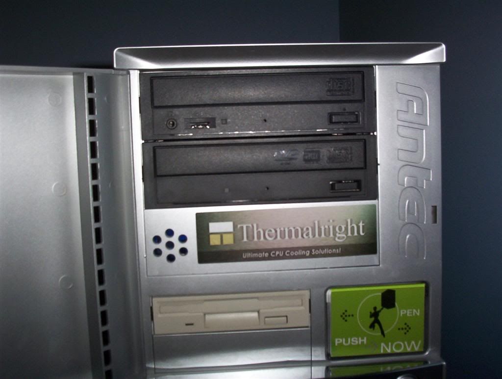

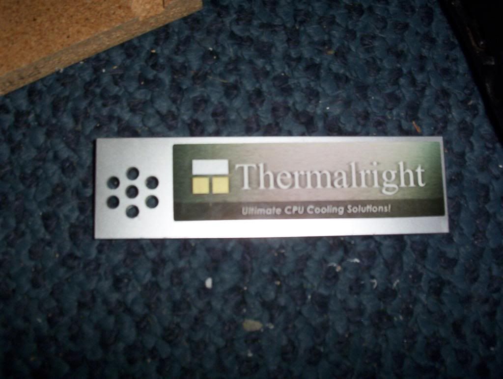

The finished product. Looks quite nice, 'eh?

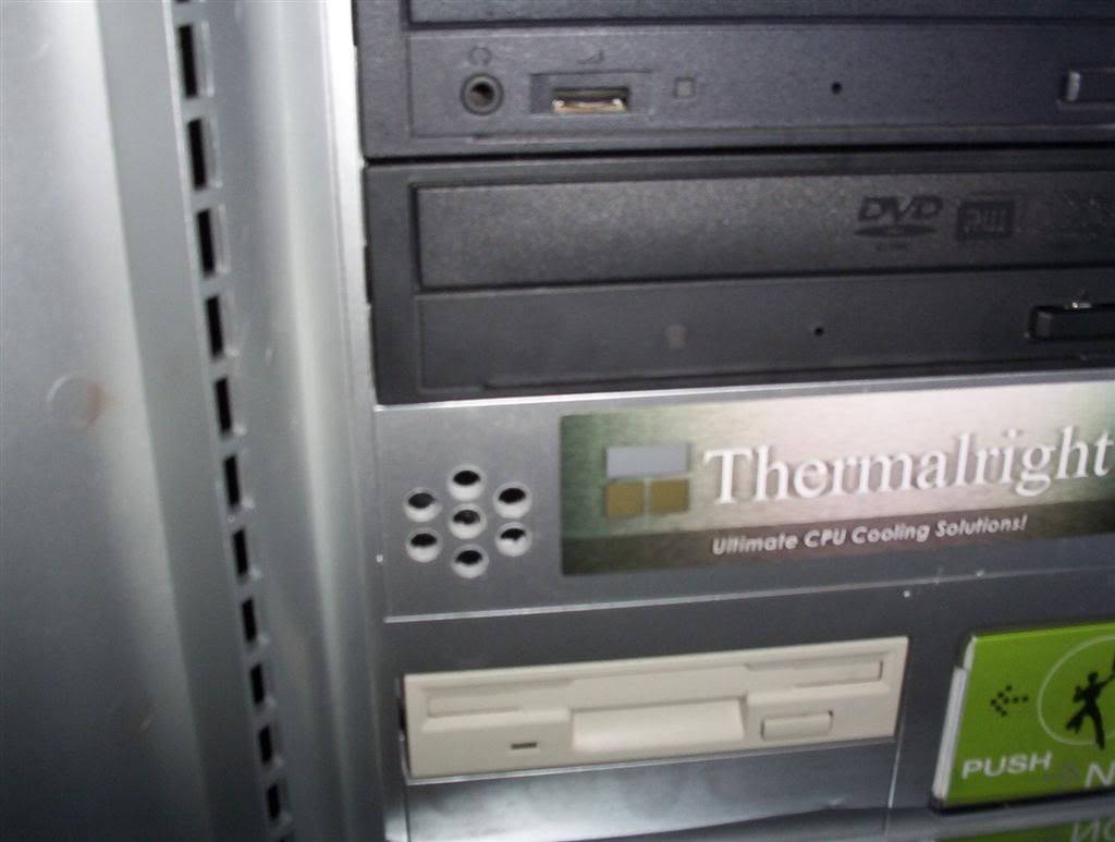

Snapped back in.
If it's a bit rough around the edges of the holes, I just took a paper-towel and rubbed the exess plastic away.
If I hold my fingers to it, I can feel air being pulled in. Also, if I close my door, I can feel air being pulled in through the vent's.
Temperature Drop
My case temp overall, dropped about 2ºC under load when fan's kick up, which is quite a lot.
My CPU temp seem's to load @ around 46ºC now, which is 1ºC lower, as it's summer..it run's warm.
I'm glad to see a noticable improvement though!
One of my Bezel's.
Snapped back in.
Temperature Drop
