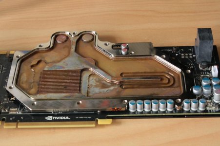

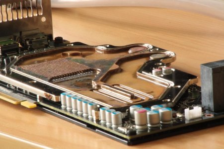

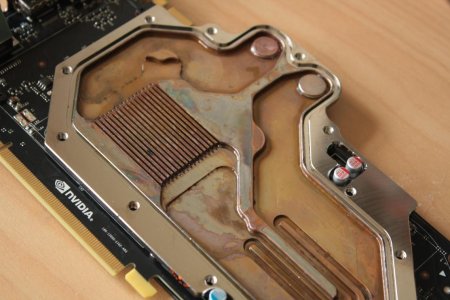

So, here we are guys. Just wondering what I should do about my block? Here is what it looks like with only 2 months! of use, tried to clean it off,but doesnt seem to come off at all...
Only used distilled water, 2 drops of mayhems green dye, and 2 drops of mayhems biocode.
Thanks!

dear me that does look bad for a new piece of kit.
have you spoken to ek yet ????
Yes, I agree. Am going to contact them, just after anyone can shed some light on anything i can do to clear it up a bit? We will see, does EK replace them directly? or do i have to send it back to where i bought it (performance-pcs) Which would both be a hassle (ek&ppcs) as i live in new zealand, so wonder what shipping would be like!

Very strange. I'd recommend contacting EK about this definitely. If I had to guess based on these images I would say the block you received did not go through all the steps required for plating it correctly and that has caused what you are seeing here. But this is just my guess I'm by no means an expert on corrosion.

Seams like something acts with it and i doubt it would help to clean it as plateing is cone and "metal" is left(looks to me so).
So if you get new one, you should find reason for it firsth and then install it back. Because i belive it would look exacly same in time.:huh:
