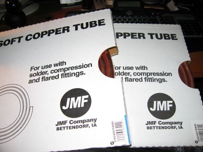

Just found out I bought the wrong kind of copper tubing, bleh.
Just now ordered the right stuff from Under The Ice. I'll return the other stuff to Lowes tomorrow as I'm pretty sure they don't carry the right stuff as I would have seen it.
