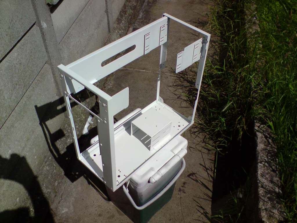

I cant be bothered to do any logging anymore, too tired, BUT, i'll let the pics do the speaking,
Still not finished but im getting there....

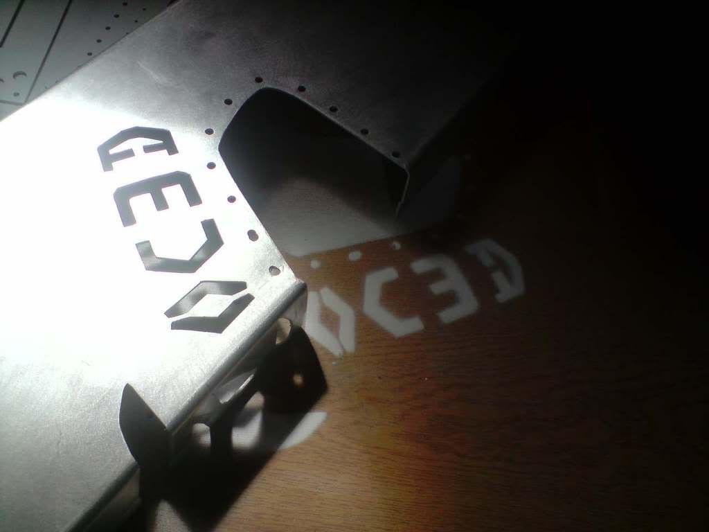

Had to do some advertising XD

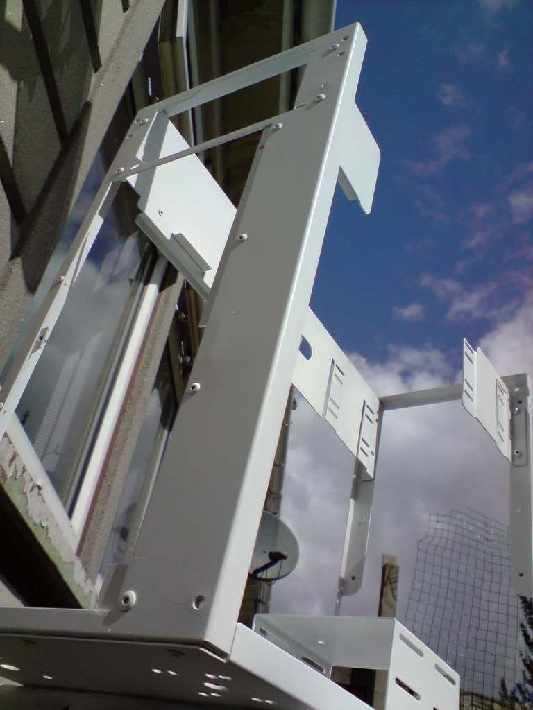

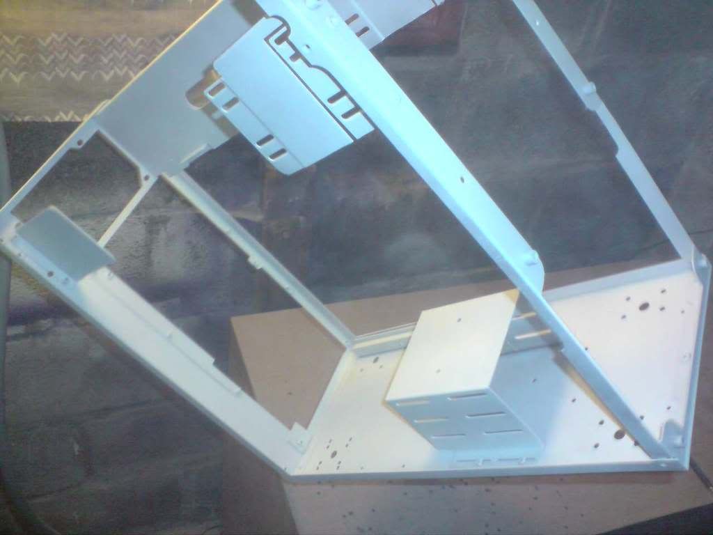

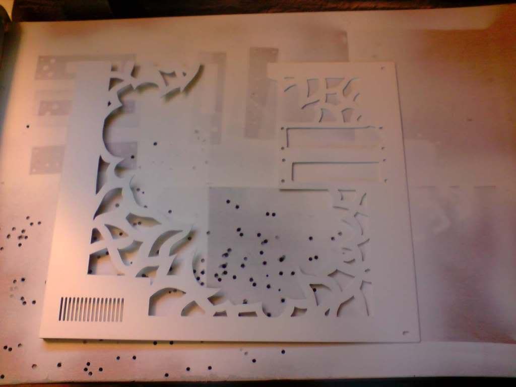

Then some spraying had to be done.
then some more spraying, and blah blah blah....

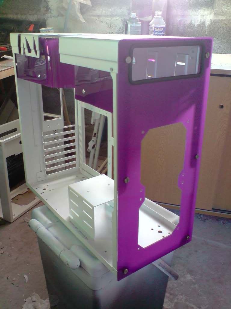

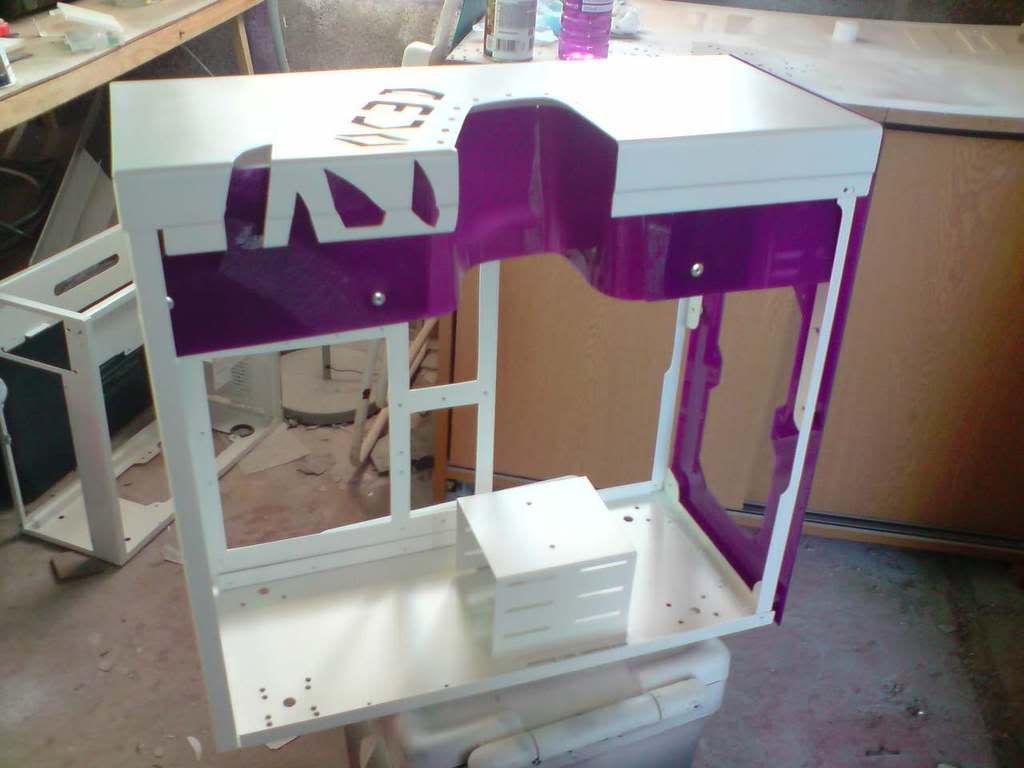

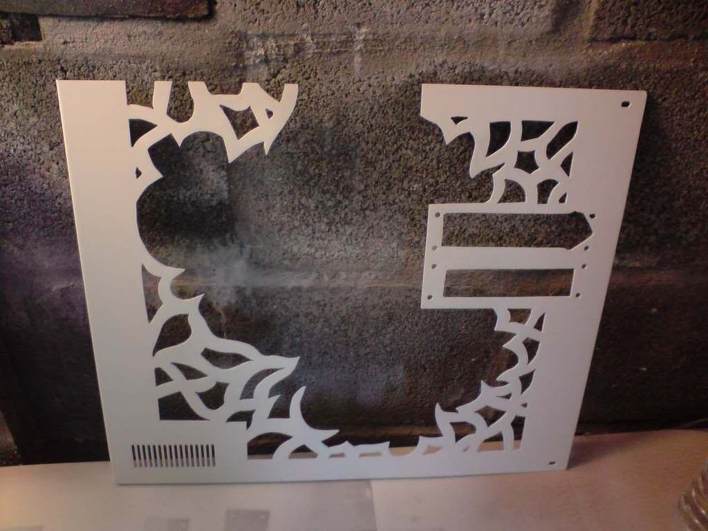

This is my pride and joy of this build, THE SIDE PANEL!!! 12 Hours of slavery, boredom (quite relaxing tbh) and a bloody sore hand and digits from filing with needle files and slipping. :oops:

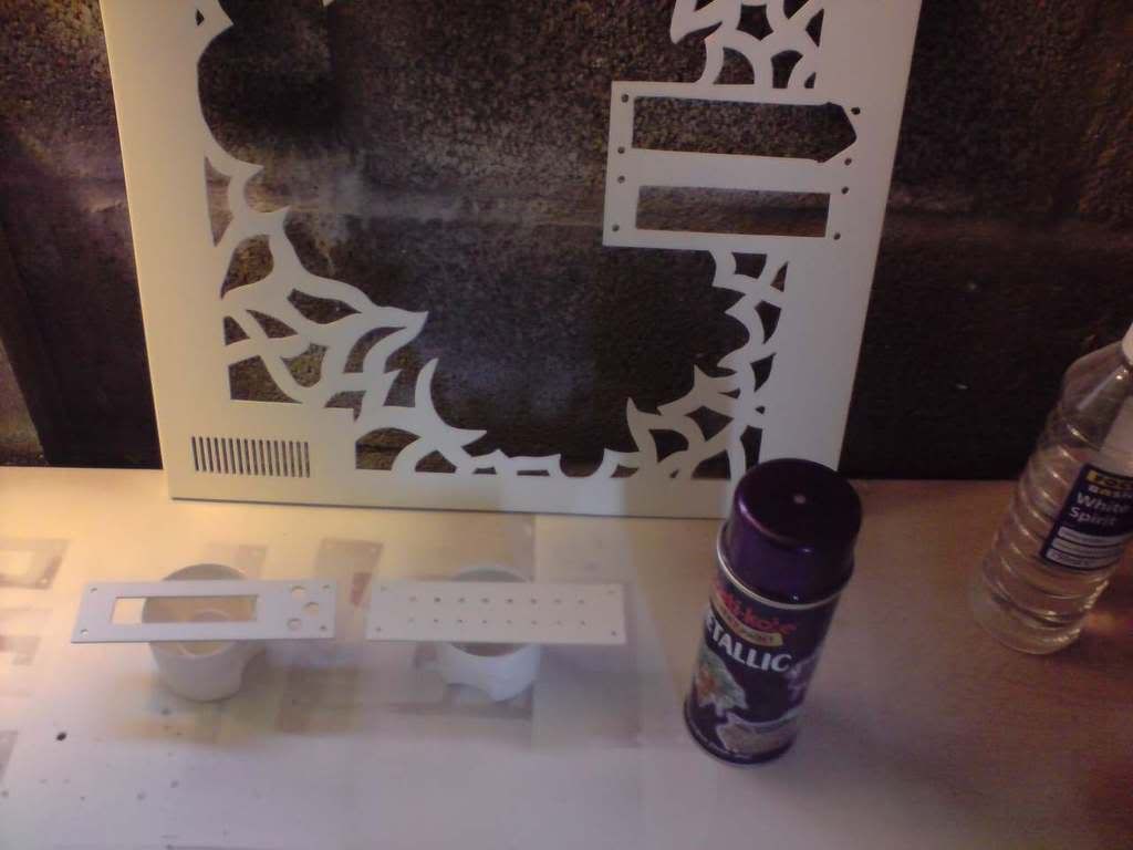

Aquero thingymajiggys:

oooh....that white/purple contrast looks stunning. and the side panel is so cool...though i guess al that effort is what makes the result so satisfying...laser cutting just isn't the same.
looking real gd! well done man im impressed so far

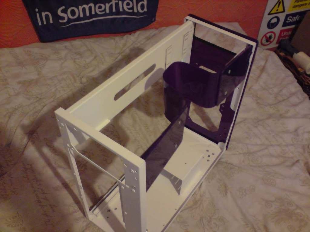

Is that purple stuff acylic :s... where do you buy it from i was in B&Q and for like a 1mx1m sheet of clear acrylic it cost around £40 what a rip off lol
and how do you bend it :S? im guessing u just used a lighter on the edge?
EDIT: one more thing, what is that white spray for? and what isit? just ordinarry spray paint

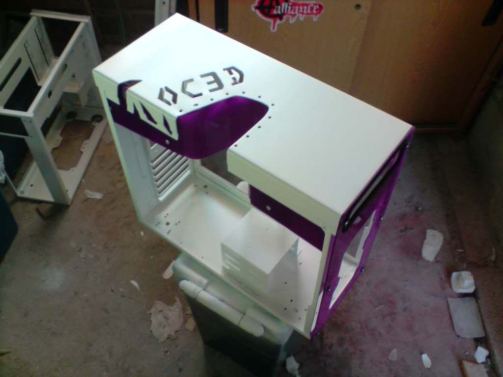

The purple acrylic i bought from ebay for about £15 iirc. Its only 3mm thick as i dont need it to be too strong. Originally it was for another build but then i used it for this one.
The spray paint is standard Plasti-Kote Matt Super spray, with Primer Super underneath, then that Metallic purple is going on top. Should hopefully have that done tonight, but i may leave the white to cure and harden a bit more first.
Cheers for the good feedback guys,
BTW, I originally bent the acrylic with an old iron, alot of time and luck. :rolleyes:
When I was doing acrylic bending in high school used to weight one end and use a straight end the my Mum's hairdryer.
Perfect straight edge and quick.
Acrylic has probably change in the last 10 years though :rolleyes:
That is a gorgeous side panel. If you cut that out you have some real talent.
Notice the Aqua Aero and Multiswitch covers below too. Are they for the two 5.25" bay holes?
