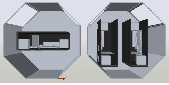

Hehe :D. Once again thanks for the help. Hopefully this aluminium company gives me an answer to wether what I asked was do-able otherwise its back to the old fashioned Weld and sand routine :P.
As for the design of the case I think since it is a Octagon the theme will be a thermo nuclear device... with all the parts.. serial number, flip switch, black and yellow paint, lovely green liquid lit up by led's inside etc. If I ever take this abroad I bet they will want to see everything inside before they let me on the plane :P.
and how could I forget, a lovely count down timer :D
Pity this case of mine wont be much use.... hmm maybe I could take it apart and use some stuff for the Project case.
Looks so nice... its a pity really.

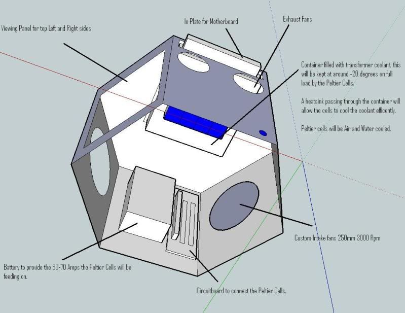

This is what I have come up with so far... I knows its a rough estimate Monkey7 but here goes :P
That case may be the actually size of a Nuclear Warhead... Lol a Green WC loop will look epic on it... And if you ever want to sell it he'll i'l sell my house and get a VTOL V-22 Osprey to pick it up and drop it off to my house (DHL might have a spare VTOL :p shipping might be a b*tch though :D)...

Please don't kill me Monkey7 but its back to Octagon....

I have been doing research all day about oil cooling with transformer oil and other non conductive oils, looked up their dieletric properties, hydrolic pressure and many more things. It turns out Transformer Oil would have been my best choice.
Having a normal Chip with no connections or pins or a circuit board where the connections are wires would be fine using oil and would last a long time.
However since Motherboards and Graphics cards have other eletrical componets where at first will work 100% even for a year or more, the tendancy is that they will not function as well after a while due to the Oil's properties.
Basically if you wanted to do this for Benching every once in a while you would be fine. However for long term and ongoing use I was told by many informed people ( even went to local radio station for answers ( they use Transformer oil in their cooling ) that it would not be practical.
^^^^^^^^^^^^^^^^^^^^ was bad news.
The good :P. The entire project is still going to be done :D. However with some changes ( more money required lol ). I will be making a modified WC system that uses the cells to cool the OIL ( in pipes this time ) to various system components. ( still aiming at a good -20 permanent ).
Yes I know wall of text sorry. I will produce more information on "new" setup shortly.
On a funnier note I could use Vodka in the pipes... it has a low freezing point :P.
Seriously, I forgot to mention that Oil has pour points ( to much to explain ) anyway I need to find a liquid thats not to thick and retains its properties as low as -60 Degs.
I vote for vodka :p
Main problem with subzero WC would be insulating the motherboard, because a cold hose will cause a lot of condensation.
Argh. hmmmmmmmmmmm *thinks* .*beep* ... *beep* aha!
What if :
1: the motherboard is set in a position that if condensation forms it could only drip away from the Motherboard. ( this is a custom case after all :P )
2: Still use a container for the motherboard and have 2 cells at the bottom with 2 fans moving all the cold Air through the container thus removing any humidity.
3: You tell me :P

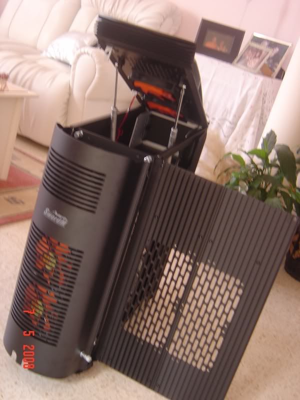

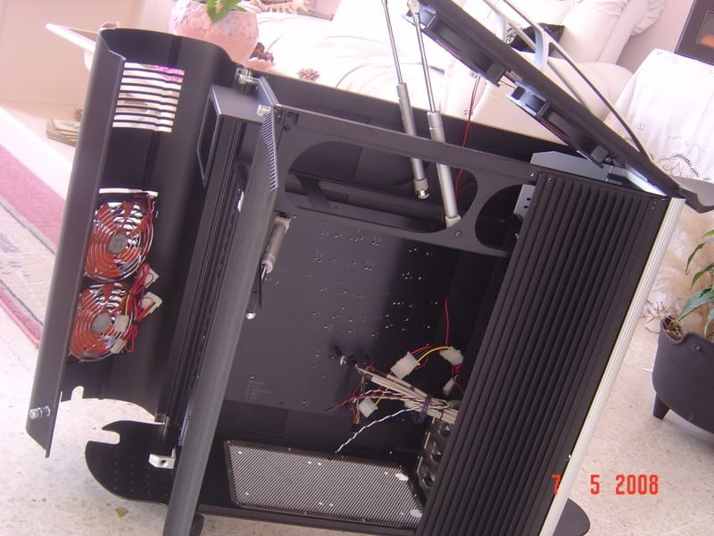

You know having had some time to work out some things in the work shop I think I will be fusing this lovely case
^^ thats the back Btw.
Still not sure but since I was not going to use this case anyway and I really like it... I was thinking why not make it a hybrid by using all the parts/ using the same case but making it bigger white retaining its coolness :P
