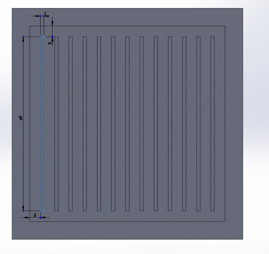

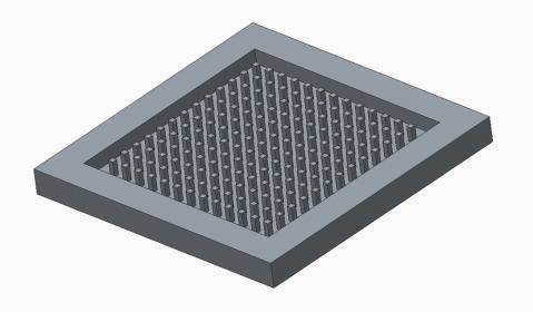

Anyways, here is a plan of the CPU water-block I want to make.
The block is 55x55x5 (mm), with the pins 1 mm square by 3 mm deep. Each channel is 3 mm wide.

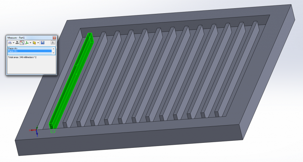

Each tooth has a surface area of 13 mm^2. There are 169 teeth (13^2) so that gives the teeth a total area of 2197 mm^2.
