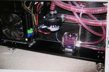

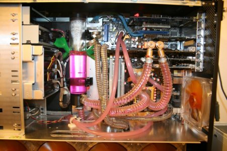

actually i have a CPU to do also, so would it be an idea to remove all the water? do i need to put paste on the cpu? i have a detachable tank that i pull out and take the top off, do i need to take all this out, or does all the water come out from the res? ive seen videos of people using a bottle with tubing, where can i pick this up, also would it be a good idea to get new coolant, and which is the best to get? Thanks Dave

I have my v2000 set up almost like that with the res where you have it, what i do is flip the case onto the roof so the res fills up with water, then just unscrew the top so all the liquid leaves the loop, better yet take a spare barb and some extra tubing and attach it to the top of that ek res it makes it easier to route the water into a bucket or something. Also I always re apply thermal compound to the cpu anytime i remove it, but make sure you clean all the residue off for proper contact.

Kool, will that empty out all water?
Ah for the most part all the water should be gone, you may have to shake the case around to get all the smaller pockets of water out. There may be some remaining water left in the Rad and prob a couple drops in the pump

gave it one attempt, but didnt manage to get all out, still a fair bit in there...as theres so many loops...is it possible to drain loop by loop, as there literally half empty or more, with the cpu block is there water that lurks around it after the loop is drained? also is there a tool needed to detach and retach the watercooled GPU, o can it be done by hand? cheer Dave
Just to let u know, all went well with cpu/gpu change over, just had to mess around getting the liquid out...but up and running thanks again!!!
