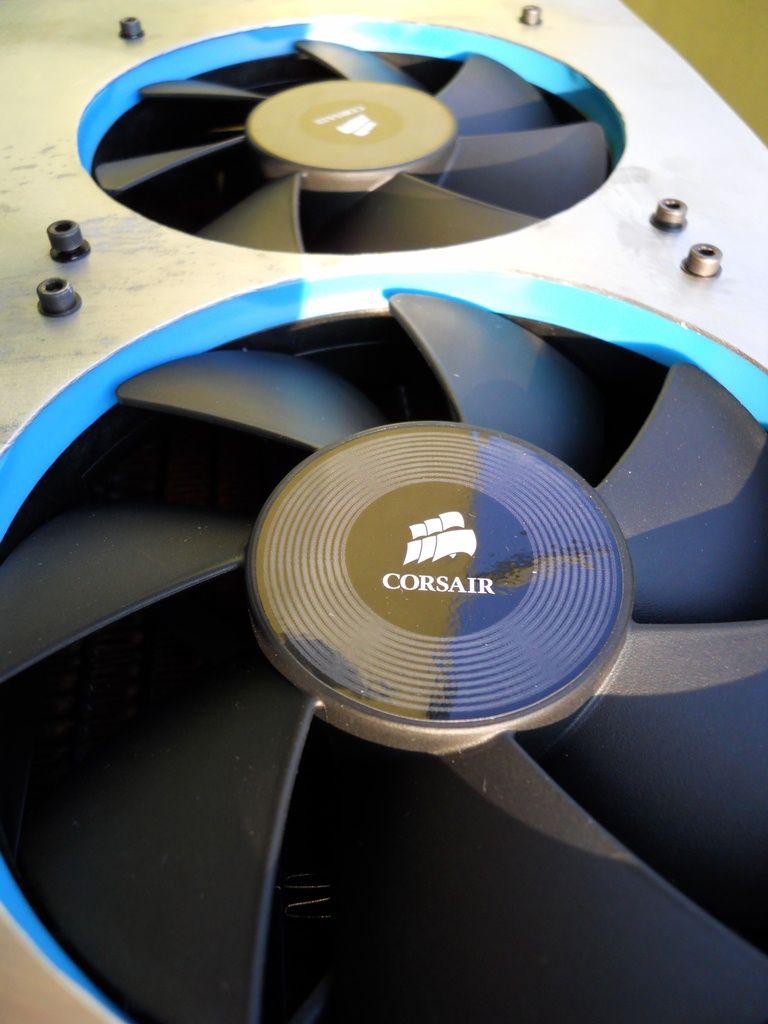

I wouldn't doubt you could run everything without fans with what your cooling. Saw this in another thread and temps were high but still lower than what an air rig would have been.

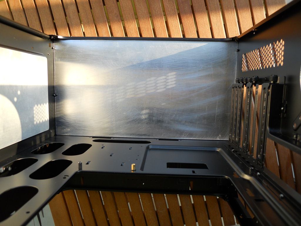

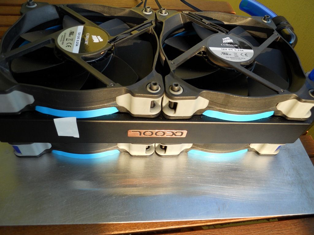

Some measurements for those asking questions ('will it fit?'), with 2 240 rads installed as in the pictures on the first page (using default holes).
Note: it's only accurate +/- 2mm and for initial planning only. Before buying or deciding on anything, please measure yourself :)
In the front this is 240 rad, there is place for 360, but watch the spacing in the top.
Hint - you CAN have a layer of fans in the front, outside, but this requires removing the filter. Both fans and original filter will not fit under the front panel.
Standard fans (e.g. SP120) are fine without original filter - double checked myself.

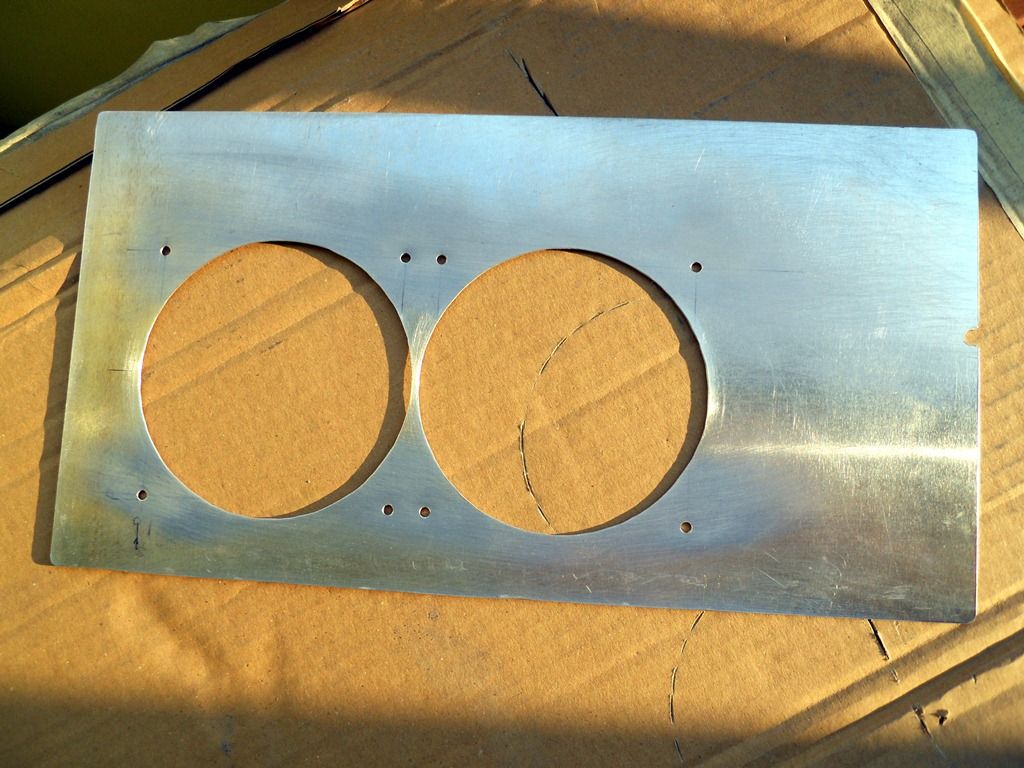

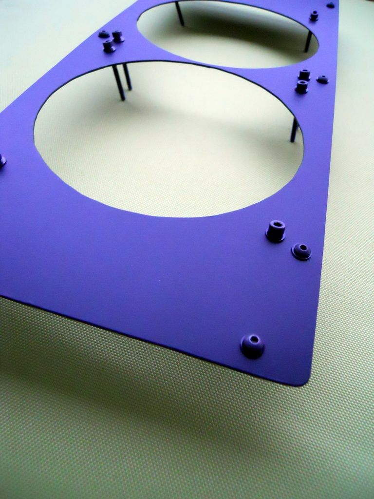

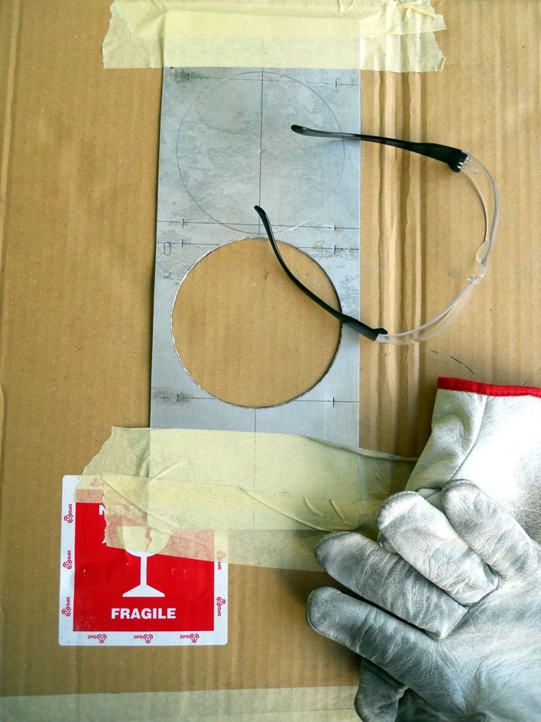

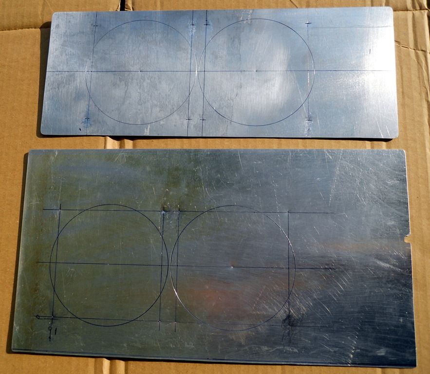

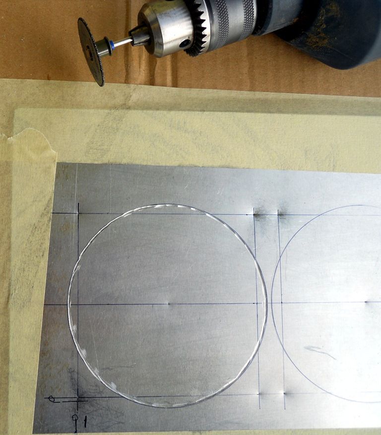

Taking my time, enjoining summer afternoon, doing some work on the project...:cool:
Are you using a power drill as a cutter? Awesome! :rock:
EDIT: Maybe a mod could move this into the build logs section? Seems to be
more appropriate IMHO.
yeah - my dremel overheated (hot summer here :cool:) - it needs to go to warranty service
it is a standard drill, but it is all right - I thought it would be worse :lol:
