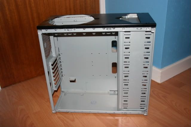

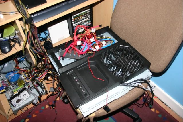

First thing is first, empty the case off all components:
Spraying the case requires just the metal chassis, not plastic, so off all that comes:
Which leaves me with a very bare chassis:

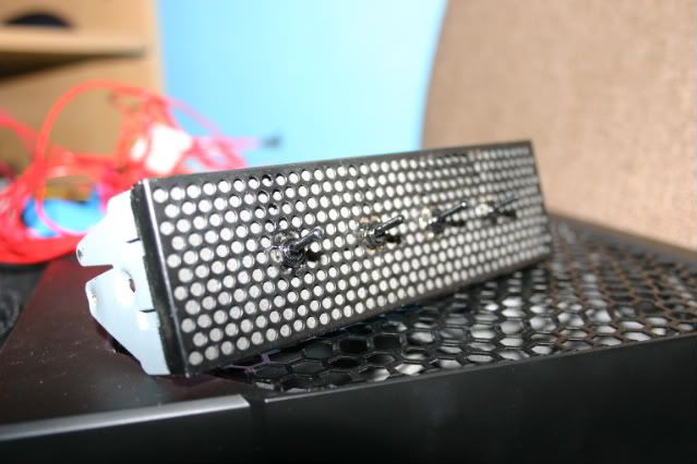

The first thing i thought let the case down was the lack of off switch for the 4 fans that come pre-fitted. So i made a simple set of on/off switches.
The switches are simple flick switches from Maplins, they come in silver, which doesn't match the case, so i painted them black using some gloss black enamel i had lying round from my coughairfixcough days.
I could have just brought a fan controller, but IMO the case has got an industrial look to it, and i think a digital display would ruin the look, which is why i went for the switches.
I made the switch a while ago, so that has been in use for a while and i couldn't be happier with it.

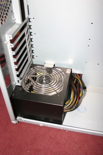

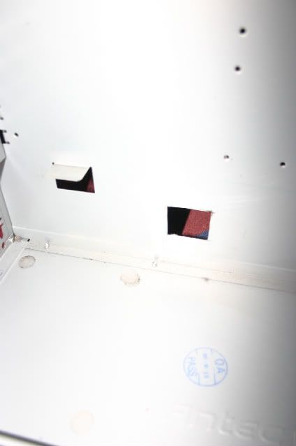

Another thing that is a big problem is cable routing. Whilst is has gotten considerably better with the addition of the 2 holes to the right of the motherboard, it is still a pain getting the cables to the holes, and you end up blocking off some of the airflow from the HDD racks. To solve this i had the idea of cutting a hole in the mobo tray so i can route the cables where they need to go behind the mobo, rather than around it.

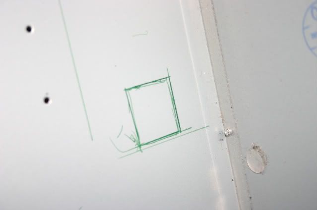

Marking out the hole:
I'm not too bothered about the neatness as i will be edging the hole with some form of rubber, so any rough edges will be covered.
The hole cut:
Now to check that the hole is in the right place and big enough to get all the cables through:
I'm considering another hole by the bottom HDD rack, though i would only be saving on a inch or so of hanging cables, so need to decide if it is worth it.

Nice start mate and make sure you keep us updated with plenty of pics. One thing though - I hope you're going to protect your PSU's wire loom from being cut by the metal edges of that hole. Are you planning to put a rubber grommet around the edge as protection?
Yep, i've been looking for some black rubber edging strip, struggling to find a supplier that will do a meter though, most require an order of atleast 10m. Another option is the plastic spines used to hold loose paper together, i will have to see if i can get some the correct size.

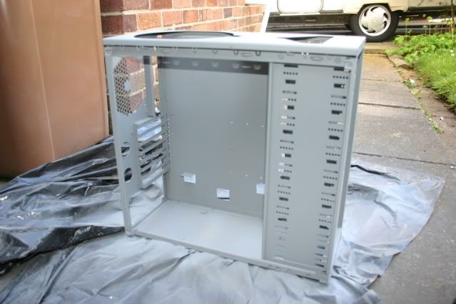

A can of primer and a patio jet wash later and i'm left with this:
Leave it to dry properly over night and it's ready for it's black transformation tomorrow!

I've still got the blue LED's to fit to the switches. I might well try and fit them tomorrow, i'm not looking forward to doing it TBH, i can see it being a pain because the LED's aren't much bigger than the holes in the grill, so if they don't position in the centre of a hole then i'm going to have to be really careful otherwise i will end up with a hole much too big for the LED and a ruined plate.
Lighting to the switches sounds great - although try to think of your eyes, and go for a more subtle effect if you get the chance too... I can't find any references atm, damn :/
But it looks great so far!
