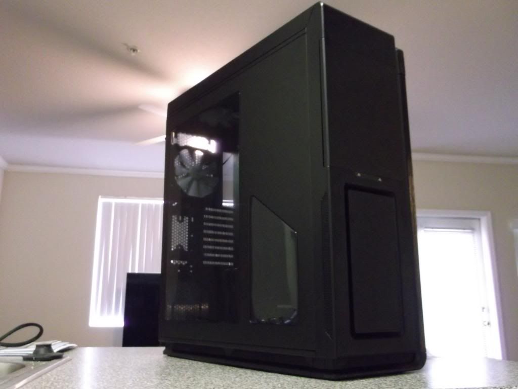

PHANTEKS ENTHOO PRIMO

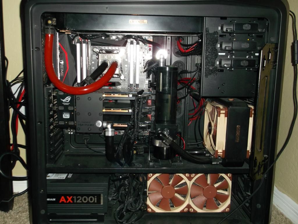

Ever since I built this rig in the summer of 2012 it has been in the Cosmos II. There were other options I was looking at, like the 800D or some of the Case Labs options. All of those fell short in one area or another. I knew I eventually wanted to go with custom watercooling one day but I also wanted to satisfy the "P" in PC so it had to have character and personality. The Cosmos II satisfied those requirements but there were challenges and there were shortcomings. I found that while it worked for watercooling purposes it was not quite as functional in some areas. While it could be modded to overcome these challenges that is not a skill that I possess at this time. So began the search for a worthy successor. Again it has to have "P" and be more functional for watercooling than the Cosmos II. Again Case Labs is always ideal for watercooling but lacks "P" without serious modding involved. The 900D has watercooling chops but is still a box; not enough "P". The NZXT Phantom series has "P" but I was looking for a certain type of character. Had to be simple and monolithic in appearance like the examples above but not plain or boxy, and not quite to the impact of the Phantom series either. Now I take a look at the Enthoo Primo for the first time. The subtle curves and brushed aluminum give it the personality I'm looking for. It has the watercooling chops. Then I watched a certain in-depth review on Youtube and it got me thinking, wow, this is a worthy successor. It costs less than the Cosmos II, I can use 480mm radiators top and bottom, it actually has a side window, and I don't even have to drill any holes or do any real modding work. Let's take a look at it shall we (and please excuse my shoddy camera and lighting conditions).
I couldn't get this shot right.... :mellow:

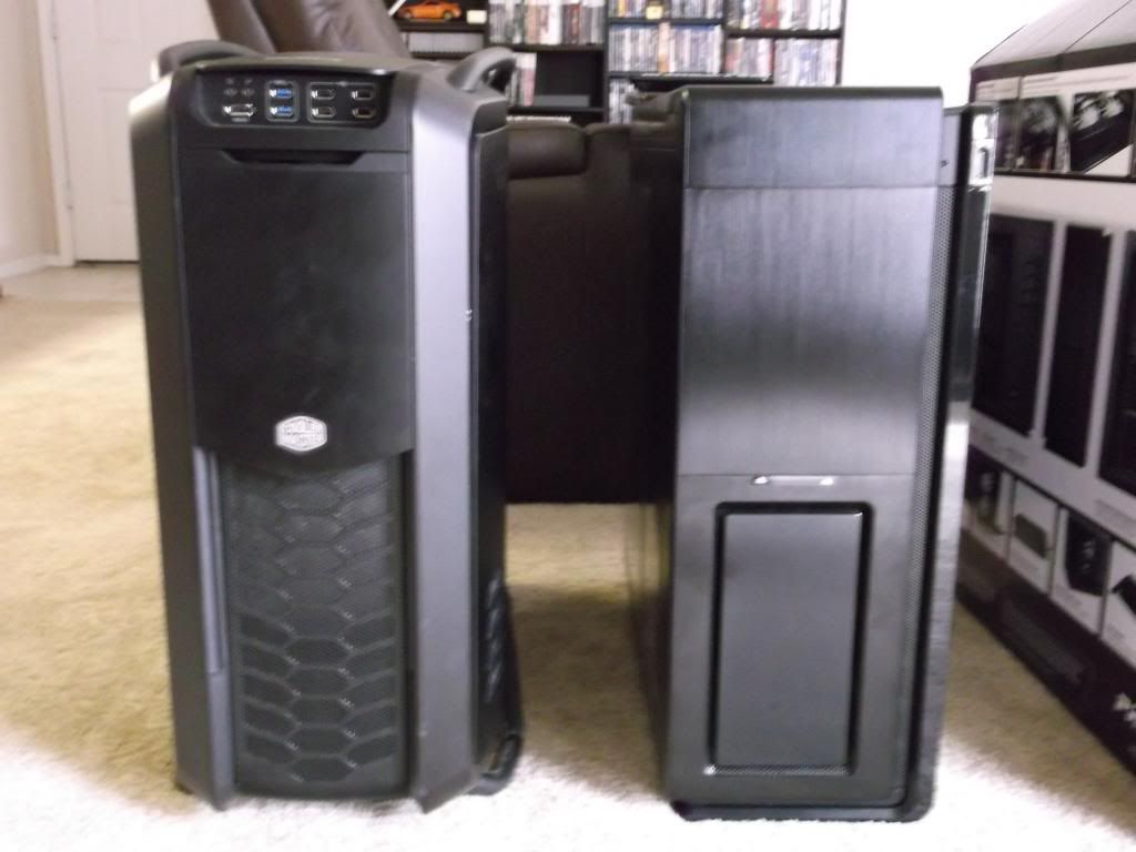

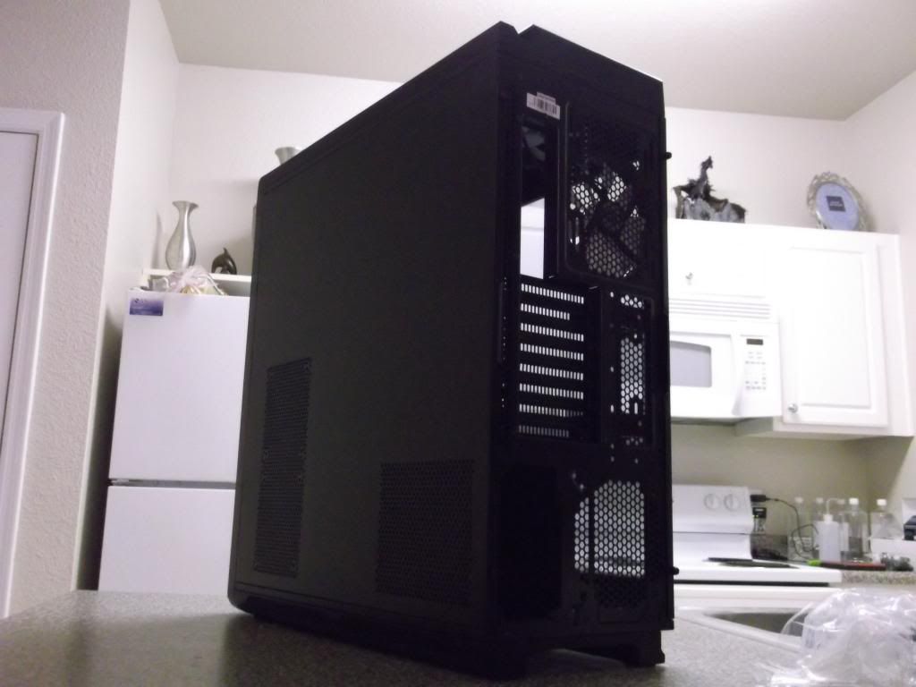

Next to the Cosmos II the Primo looks to be about an inch shorter, 2 to 3 inches slimmer, and 2 inches less deep.

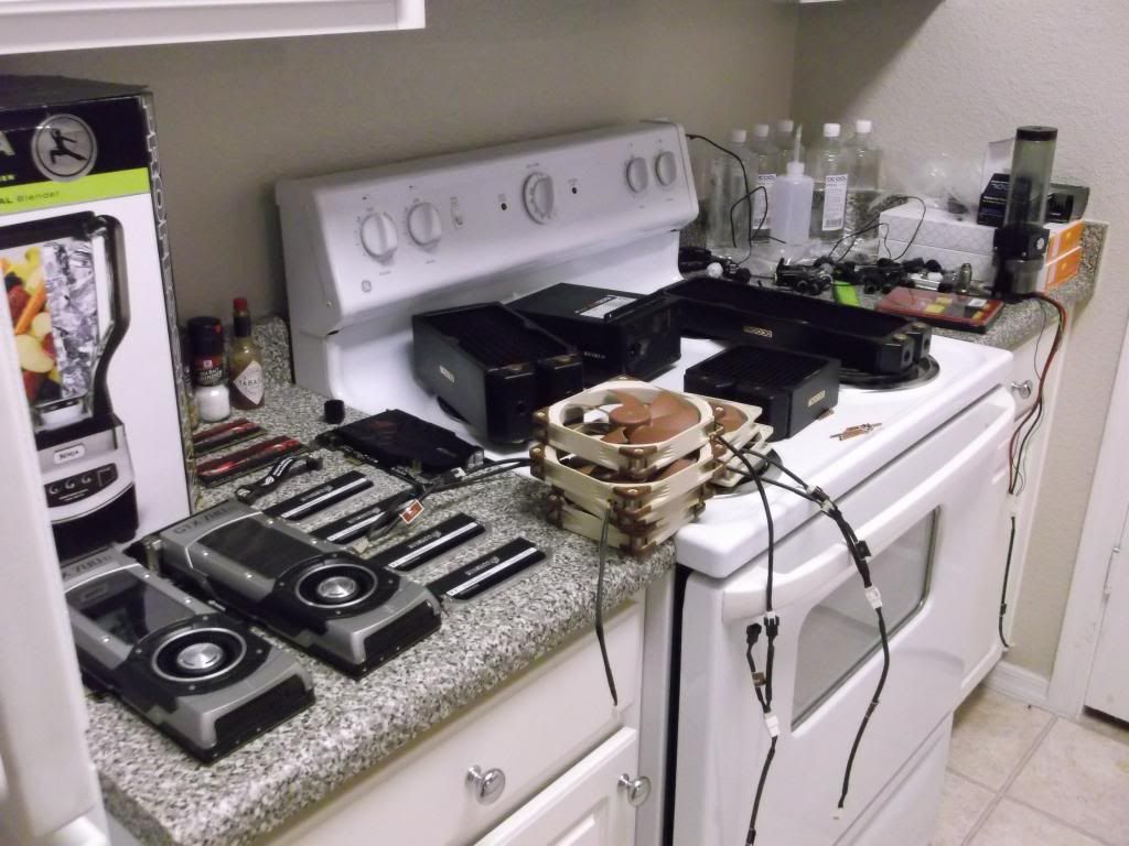

Now let's put some gear in it but first...
The former home of a mighty and powerful gaming PC
I have also taken this opportunity to do some things in the intermediary. Lets go over those.

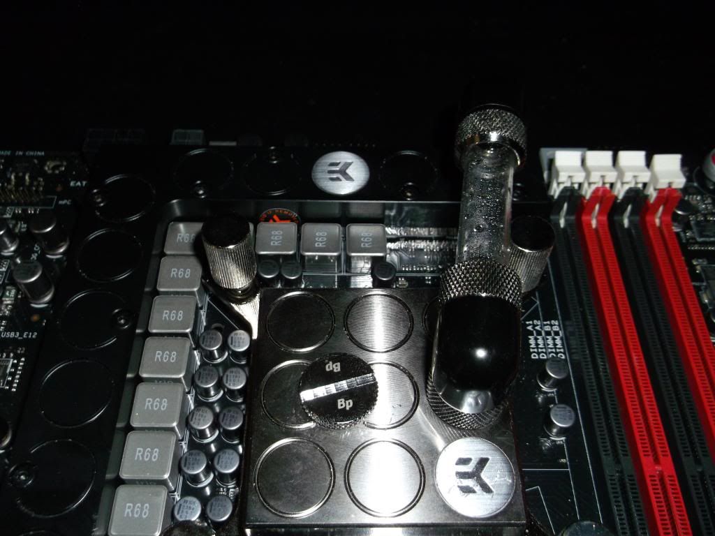

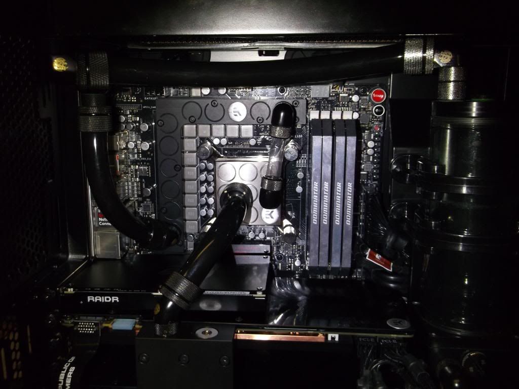

Here I have optimized the connection between the CPU and VRM blocks using a Bitspower Crystal Link hard tube. Before I was using 90 degree compression fittings and 3/4" tubing. It doesn't line up precisely but it works.

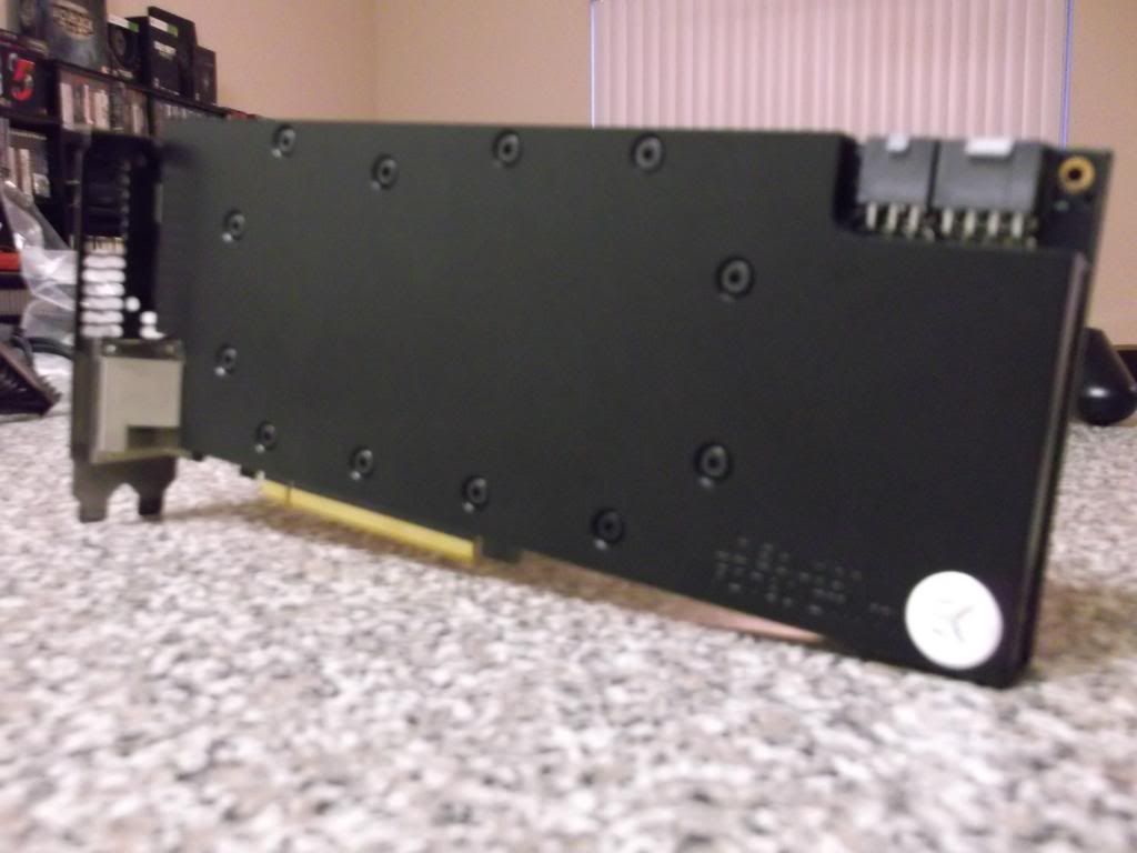

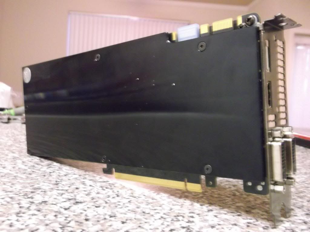

The graphics cards now have EK full-cover blocks with backplates connected by an FC-terminal. I really love the clean looks of these blocks it's just pure bliss.

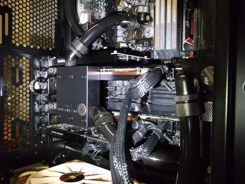

Now we can install everything.

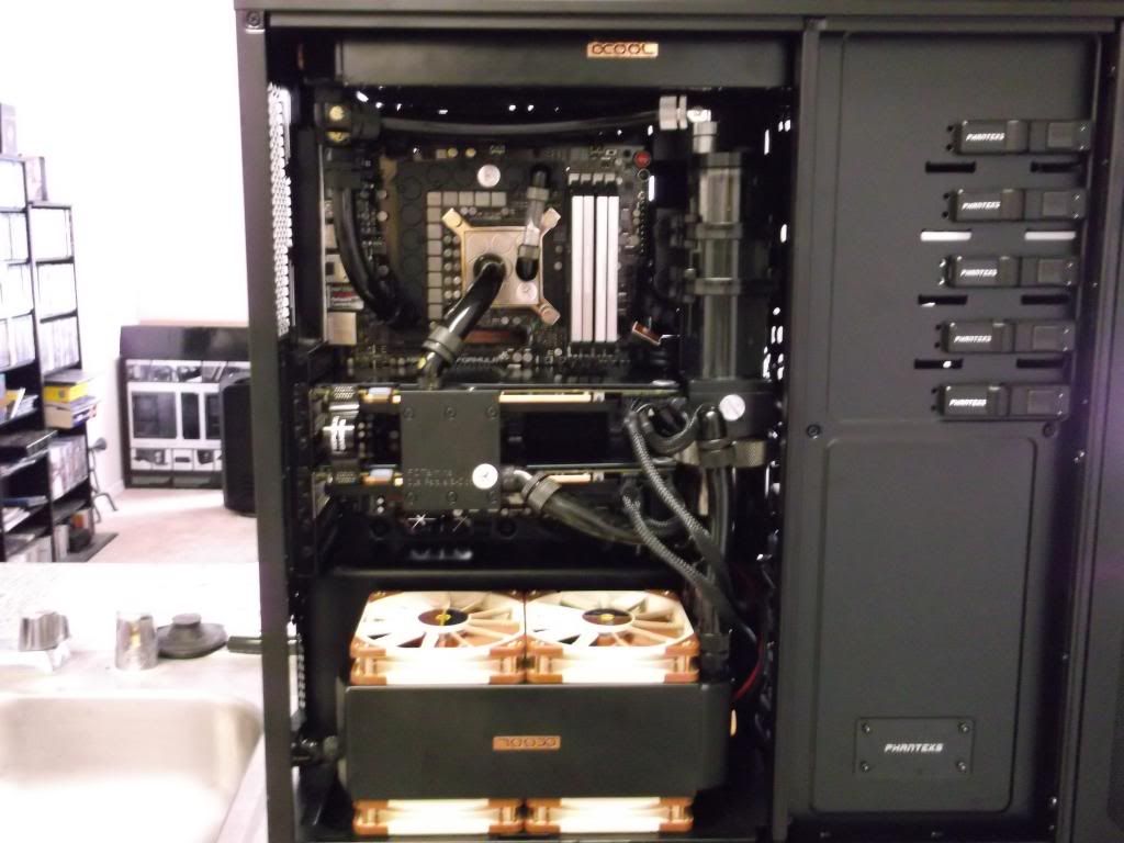

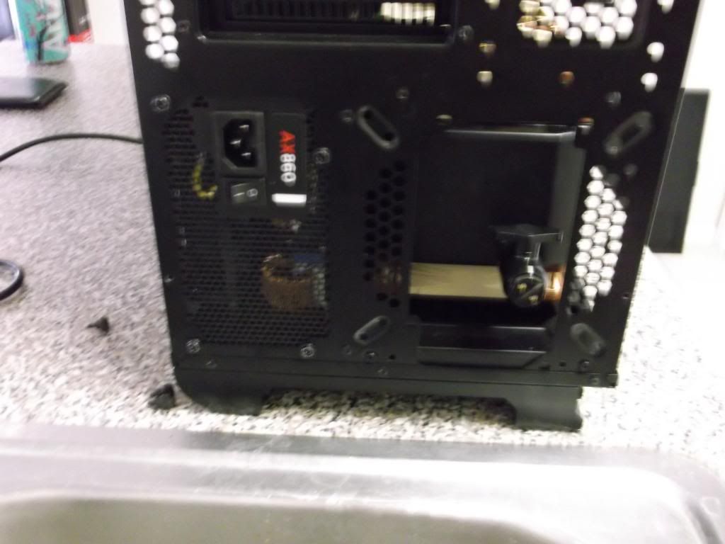

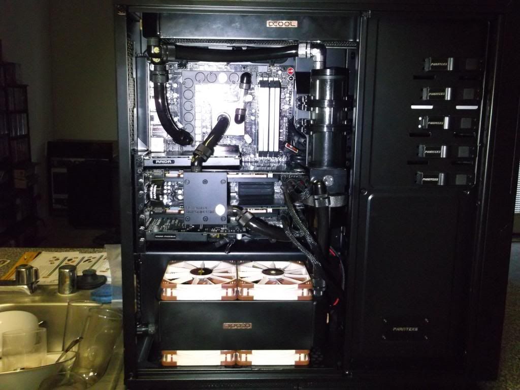

This stage of the move took me almost a day to get right. I experimented with many combinations of radiator and reservoir placements until I found the optimal configuration shown above. The Primo comes with two places you can mount a res; either next to the expansion slots or in the dedicated res mount that is placed next to the right side of the motherboard. That's what I ended up using here.
There are some things to note about the res mount. First, you will need reservoir clips. I'm using Alphacool 60mm res clips here. Secondly plan on connecting all of your cables to the motherboard first; the mount is held by thumb screws from the back and can be removed. And thirdly, should you use the res mount you will be limited in the length and number of graphics cards you can use. My GTX 780 Ti's are 10.5" in length and they barely fit. Anything longer than that need not apply. Also the mount has changing widths at top and bottom to accommodate attachment points so one can only use up to a 3-way graphics configuration. 4-way configurations need not apply.
Moving on to the radiators I am using the same ones minus the 140mm unit for now. My overall configuration for the loop is actually very similar to last time. I still have all of my temp sensors in place and the flow path is the same order as before (minus the 140mm rad of course). This time, however, I am using all black tubing throughout. Still using laboratory-grade deionized water with biocide additive as before.
Drain valve still attached to the bottom monsta rad as before. Overall my temperatures are more or less the same as before as well so that 140mm rad won't be missed.
