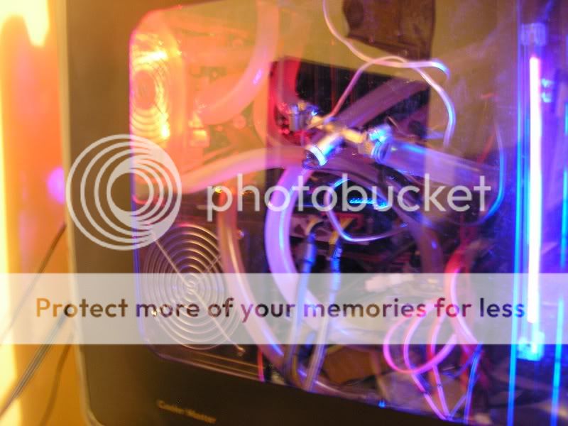

Finally I also imported a case side from coolermaster:
Photo was taken while installing the RAID card so obviously there are more cables on show

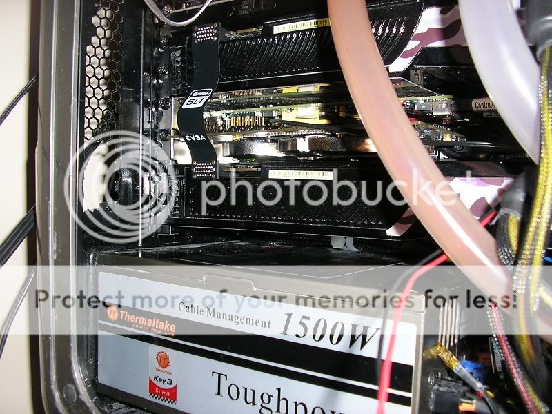

Quick update. My thermaltake 1500w PSU didn't like something and started to show a low 3.3V line, followed by doing endless F3/F6 cycles before booting, so I replaced the PSU.
Options are pretty limited, as the thermaltake is a rebadged Corsair 1000W, PC power and cooling have a very nice 1600w unit, but it was captive and insanely loud.
Ultra X4 didn't have two 8 pin CPU sockets and was too long and hard to get. In the end it was between an FSP Everest and an Enermax 85+ 1250W.
The enermax won it, with its very nice modular design and post shutdown cooling. I decided to spend the extra this time and get something truly lasting.
The big 120mm fan is cooling the RAID card, which needs constant air over its heatsink. All fluid is going to the other half of project LifeSupport, which started out as project recycle, and now has basically turned into project "hey isn't this just my old rig?".
The PSU was the last bit of my rig when I originally built it. This also means that the total value of all my computers has got into very large numbers.

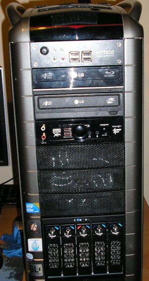

Cable management or not, i'm getting very jealous of your system dude. What is the Artigo thing you have used for? You have something to do with the sound (creative), what is that? What are the 5 things at the bottom of the case? Something box but I can't see the whole thing.
Cable management is now pretty good, I made a real effort after I built project LifeSupport (with my server housing the pumps and rads as it runs cooler). The artigo is a PICO ITX PC, a fully functioning PC with a 1GHz Via C7 processor and a 120GB disk.
Its really slow, but it does stuff like torrenting and downloads fine, which is mainly what I use it for, as it uses so little power and is pretty quiet so I can leave it on all night.
The Creative thing is part of the Fatal1ty Champion package, basically just a volume control and headphone/phono out, which is good for really late night work, when 560W of sound is not appreciated by the neighbours.
The box with 5 things is an icy box drive caddy, which has hot swap bays in, lockable and with error lights. It has a fan (which I replaced for a Silent Eagle). Its basically so that if any of the drives in the RAID array fail, I can replace it. One of the things I bought with the RAID card.

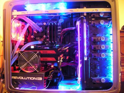

Some long overdue updates to this thread. A lot of the drives went over to my little storage server, which has since had so many bits added to it, it got too hot in the Asgard and had to be put into the Xaser (I'd like to put it all in a fortress 2 or similar but oh well). The server went into the Asgard, with a recovered 280GTX. I moved all the watercooling back into the cosmos for an entirely self contained fully water cooled behemoth.
As it stands, Loop one is on the motherboard and CPU, cooled by a TFC double and a black Ice GTX single rad. The single is in the very front of the case, with the pump right behind it, and the double in the roof. This leaves me with two 5970s, which at stock run red hot and obviously heat the rest of the case up. I have a thermochill 480 on top of the case, with the hoses going through the grommets on the back of the case. Not the tidiest of solutions, but a 480 is hardly small. The blocks are EK acetal, which are relatively easy to fit.
I've had a nightmare with the 5970s, as one of the fans started shrieking, leading to an RMA (before I watercooled), I was then sent another 5970, DOA. Anyhow, the loop is all up and running, with loads of 59C after half an hour of kombustor multi GPU, at 900 clocks. Any other program runs in the mid 40s, so I can't really complain (even folding runs a lot cooler than furmark).
What water blocks are they dude? Looks good but there are a few of those tubing loops that could be made to look a bit better. We all know what Im like about tidy though!
The GPU blocks are EK Acetal + Nickel, really nice looking blocks and the performance is phenomenal. With just the one card in the loop 45C after 30 mins on kombustor. I would have neatened up the loops a bit, but I ran out of cash and ended up reusing a lot of tube, most of which wasn't the right length. I'm also using 1/2" ID, and after scalding myself earlier with boiling water bending one tube, I though better of it. I'll probably do a nicer job when I have time...and tygon.
