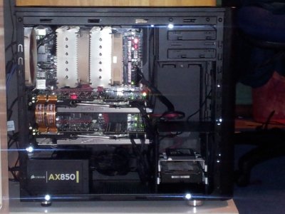

hey everyone,
I recently purchased the fractal arc and I absolutely adore the little case, ive managed to fit a r3e in it and 2 580 lightnings with a little bit of difficulty in hiding the cables but it still looks neat
essentially I wanted to build a baby shadow h20.. ok heres the ideas that swarming around in my head atm

If you're willing to take the riskier job of cutting a hole for a side window, I think you'll find drilling out the rivets to get out the HDD cage easy. But first always measure that you can fit the RX240 in between the floor and the 5.25" cage before drilling. You also need to think of whether you have the option of mounting the rad onto the existing front fan screw holes, or whether you need to create mounting brackets.

I don't think you can mount the rad to the fans up front, the fans are attached to the front bezel not the chassis. RX240 is enough for the CPU I think.. What graphic cards are those?
right guys Ive decided to not go with a rad infront because I didnt realise id have no space the hdds so I guess im mounting it in the top
the rx240 should cool a 950 at 4.4 - 4.6ghz yeh?
It's a shame they didn't make both HDD trays removable, you could have moved the bottom one to the left and completely removed the top one then getting a rad in the front would have been easy.
Also, yep the RX240 should be enough.
