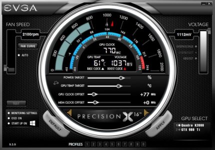

I also discovered that you can overvolt and overclock a Quadro - Who knew?
