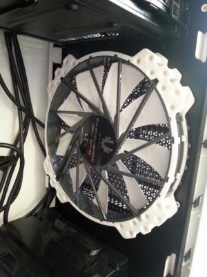

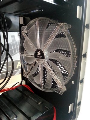

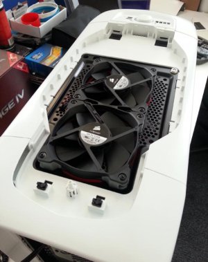

I am almost through my current build using a 600T SE case, I have replaced my stock fans with Corsair 120mm SP and AF fans.
I am with ChrisGlobe on this for my setup and my basic understanding of the laws of Physics on what air can and will do, but these setups are all different and here to be tried so both iterations are worth a look.
For the front of the case I have replaced the front stock 200mm fan with a 'BitFenix Spectre PRO 200mm' It is not a Corsair which I would have preferred as most of my rig is BUT I couldn't really find a decent 200mm replacement up for the job, with a little bit of research and always a lot of very useful advice on here this was my preferred choice. So far good.
I may even get my dremel out yet to cut away and modify the front of my case to accommodate x2 120mm Corsair Fans IF I don't think I am getting the right airflow. So I may end up potentially with x2 120mm SPs hopefully doing a better job !?
I must mention to help with the airflow I am not running the usual HD configuration so really there is nothing in the way of my front case fan, I am just running SSD's, the actual x2 housings to accommodate your Internal Hard Disks within my case I could remove and fitted just one these housing units deeper into the case and lower down thus leaving a bigger space cavity for my FRONT AF Fan to push more air in.
This setup seems to work best for me at the moment, but as you know all rigs are different its just finding that best combination, hope any of this information helps and good luck !
