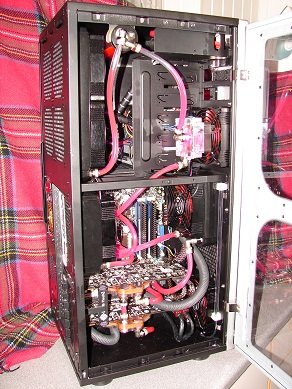

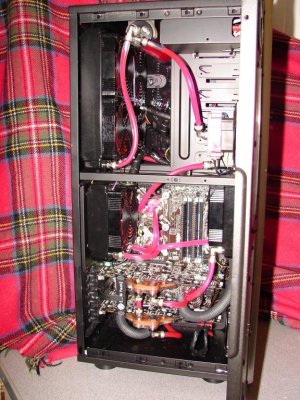

could do with a picture that's bigger than 'for ants' mode to really judge itBut it does look a little hellish in there layout wise

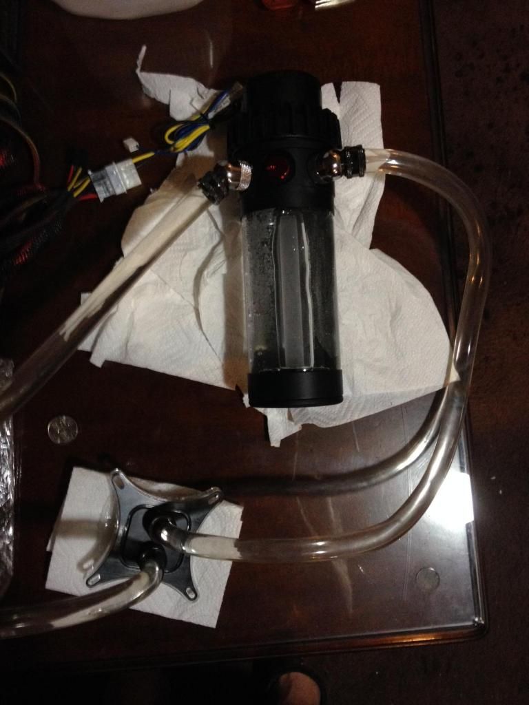

What is the best way to clean an old loop? I've never been able to afford a loop but then an old lady droped of a bunsh of stuff at my work including a feiggen swiftec watter cooling loop but I need to clean out the elgey and replace tubing. I bought white viniger and orange juice today. Would that help? Along with warm watter? It still has 1 of those amazing swiftec pumps I dont wanna damage it.
