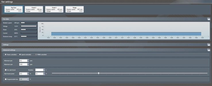

You have 4 outputs on the XT6. Each can be set to Speed, Power or PWM
This is done in the software.
So for instance
output 1 6xPWM
output 2 6xPWM
output 3 3xPower
output 4 Pump
You can the add the 3 outputs to 1 controller setting an run from water temp
And then output 4 at a fixed speed. Or 2 steps, an idle, and the when a set temp goes above a limit, it ramps up the speed.
I have all my fans set to a fancurve that follows the water temp. Output 1 is 120mm PWM and the other outputs are 140mm PWM
In the outputs, you can set a max and min speed of the fan. Start boost, so you can lower the running speed even more.
For ease of use, and a ridiculous amount of less cable management I use the Swifttech 8 fan hub.
Was skeptical if it would work at first but since its cheap id give it a go. turned out great. All fan cables nicely out of sight and only one leading to my 6XT.

This is my controller setup, and below the fan setup
