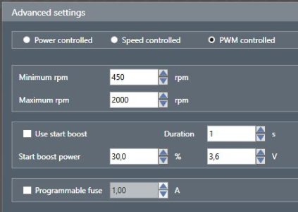

@BigDaddyKong, have you tried to set a Start Boost Power? And then setting the fans lower than 750rpm???
I don't have it up and running right now. Going to tear down and reinstall over Thanksgiving break in a couple of weeks.
