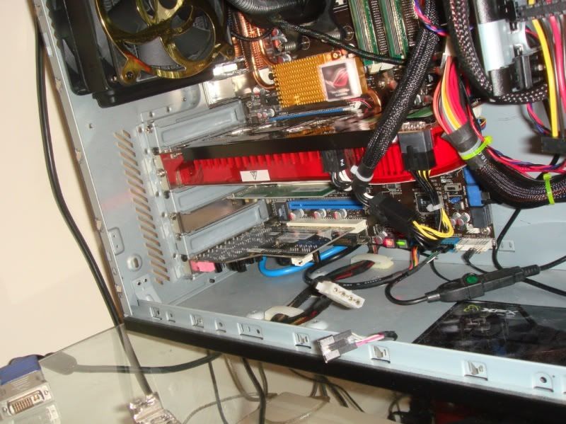

Quick post from 640x480. It's here and it inits and works pre driver. Just dling the latest cats.. 'Thermal tape' was a con, it's double sided sticky tape. Bastards :(
So the Ultra is just going to back together as is and sit on the shelf.

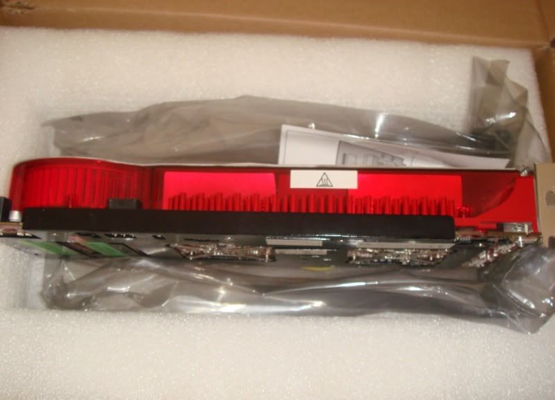

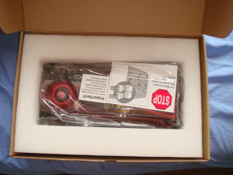

Any way, right now I am too pleased to give a crap about it really... The 3870x2 arrived thismorning. I was extremely apprehensive as I had just almost been burned. That worked out bloody well as I would never have gotten £75 for my D2X. They're only around £100 new now. So the card came and I carefully peeled off all the brown packing tape. I wanted to try and keep the box.
Since opening it I have ran some selotape along the inside and outside of those tears. Common problem, people don't realise you should pop open both ends of the box and push the internal cardboard box out. Never mind.. I mean, I am so anal about keeping boxes and stuff. My loft has a corner where all of my boxes are wrapped in plastic bags and stored. Opening the box it was a really pleasant surprise to see it looking original.

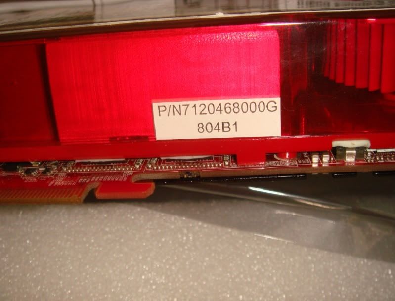

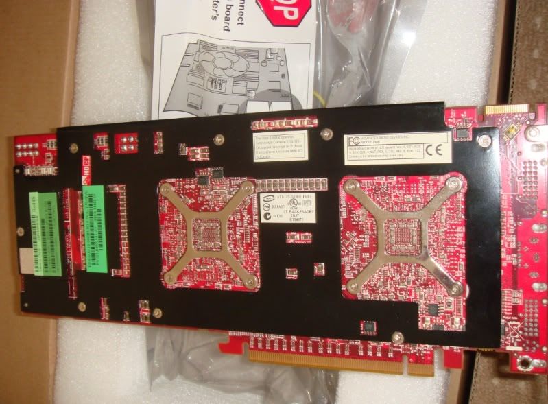

Now I was trying not to get too excited because it's so hard finding mint hardware. Usually people want mint prices for it (like cars) and £55 for a 3870x2 is too cheap. It had literally been on ebay for about a minute before I pounced as it wasn't there during my initial search and showed up on a page refresh. Unwrapping it I was greeted with this.
Surely this is too good for £55? surely? It looked like it had been dipped in a bath of hot water. The only tell tale sign of use was the dust in the fan.
So OK, this thing has been apart right? He's obviously cleaned it all up and it's buggered? So I had a close inspection starting with the shroud. It must be full of dust, surely?
Nothing. The body is transparent and you can't hide a single spec of dust. This is too good to be true surely? Surely this card has been apart? Nope. Look at the thermal pads. They're definitely undisturbed. They spread when people mess with them and bits of string hang out.
Flipping it over I checked the other side. A good few of these have been on ebay with paint chips or broken legs. Nothing. Right now I was beginning to suspect this dude lives in Vault 101. Seriously, he must have a particle removing machine in his house.
Checked the back for tell tale signs and again, nothing.

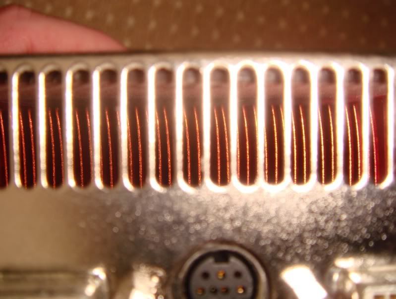

I was seriously beginning to think I had found a dude who looked after his hardware as well, if not better, than myself. Final check, look into the escape exit and see if the copper is clogged or discoloured. Nothing. This card is as close to new as is possible.

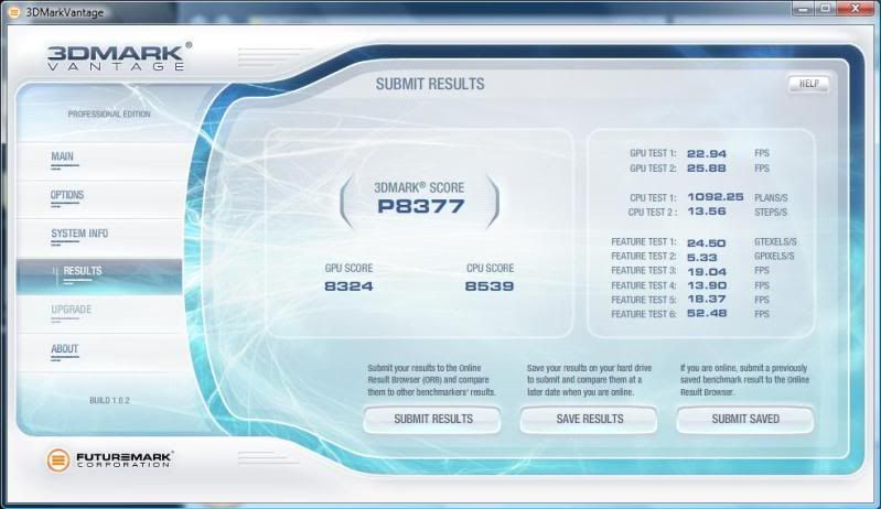

Right up there trading blows with the 8800u. Now I just hope that I haven't spoken too soon but this could well be bargain of the month :)
