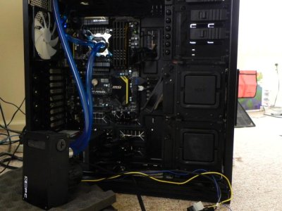

I have an XSPC D5 Dual Bay Reservior/Pump Combo and my problem is twofold:
1) Very noisy
2) Air bubbles are created when I turn it on max speed
Speed setting 1 is quiet but not enough flow, setting 3 is the loudest, and setting 5 has probably the least irritating sound other than number 1, but I can still hear it over the fans even when the fans are turned on high.
Also, when I have my pump turned on high, it sucks in the small amount of air from the top of the reservoir and creates tiny bubbles. I have the res filled as much as I possibly can. If I tilt my computer three or four degrees to the right, I do not have the problem with bubbles. It appears that the intake to the pump is very close to the top of the reservoir and when I tilt the reservoir slightly clockwise, I am putting a greater column of water over the pump intake.
I read that the noise is caused mostly by the reservoir and not the pump. If this is the case, then I'd like to get rid of the bay mount reservoir in favor of something quieter that would work with my D5 pump. Any suggestions?
