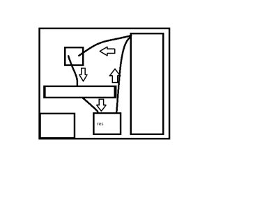

how will the loop look like, draw a quick sketch and label the water flow, with estimated tempratures.

RX360 is a start, but im afraid the 750 might be a lil weak for a dual block
rig. it might last a bit, but it will not stay alive long. mainly for a single block
loop. either the DDC or D5 would be what to look for in a pump with multiple
blocks.
you can get away slightly on a small overclock on CPU/GPU, but you'll have
to watch and regulate those temps. for testing use 8hr loop load to verify
temp stability.

yeah, it'll do it for a bit, until the blocks make it work in overdrive. those pumps
were made for a single block.. yes, it'll do many blocks, but not for long..

well the idea is using the idea of the ares 2 cooling.
basically i was thinking of having a 60mm 240 in the front in push pull then into the cpu then into the 120 in the rear then the gpu then back into res.
would that work?
im just thinking if i have the 240 in the front i can keep the top 2 optical bays to hide my hdd/ssd in
if you have no need to overclock, sure..
but any overclock you might as well look to the 360 in the roof and 240 on the
floor or in the front intake.

So you can see with my case i have little room for rads which is i thought of the 120mm on the rear exhaust
IMO, single rad usage is a waste of time and money. they are kinda a bandaid to
what needs to be done.
your options would be to:
  1. mod your case to the nth for a dual 240 (roof and front intake)
  2. mod case for 360 in front intake (60mm or fatter)
  3. change case
  4. make a simple CPU lool and call it done.
to keep things simple a CPU loop with a case mod like Toms nurburg rig.
