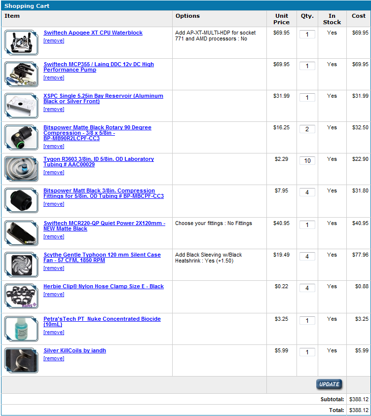

Like you I'm starting out with CPU only. I also have a 240mm rad. All my stuff is still sitting in a box waiting to be installed. I have other projects to finish first unfortunately. I pieced my kit together myself. The top of my case could only fit a thinner rad so I will see how this performs. If it's not what I want I will add a thicker 240 to the bottom of the case as well. I think I will be fine though, I've asked around quite a bit at other forums and checked different review sites after second guessing myself.

Might want to add a pump top to that list
isn't there one in there?
2nd item on the list:
Swiftech MCP355/LaingDDC 12v High performance pump
not sure if there are multiple pumps in a waterloop though, I am certainly no expert here
So basically what you are saying, is that I shouldn't bother with the kits from XSPC or EK, and just configure parts myself. If so, thanks to hmmblah for posting the list, I will use this as a guide on what I will need.

He needs a top for the pump so he can use bigger hose

Alright, so I have done some more searching and the like and I have come up with this list:
-EK Supreme HF CPU Block (65€)
-Laing DDC 1T pump (60€)
-EK DDC X-RES 140 resevoir with top for Laing DDC pump (50€)
-Black ICE SR1 240mm radiator (65€)
Now that totals at 240€ and doesn't include coolant, barbs, fans, and hose. So we are talking about more than 300€ in total cost. Now that is quite a lot of money, but I was expecting that with watercooling. However, I would be more than happy to cut down on cost at some parts, if possible. It doesn't matter that much if temps are going to suffer by 2-3°C.
Apart from that, what do you guys think about the XSPC and the EK kits I mentioned in the first post? They are both around 150-200€ and include everything, so they will be a lot cheaper. Will performance suffer much by choosing one of those kits? Because I really like those.

http://www.specialtech.co.uk/spshop/customer/XSPC-Rasa-750-RX240-WaterCooling-Kit-pid-12933.html
buy or copy that kit for a budget 240 kit dude.
