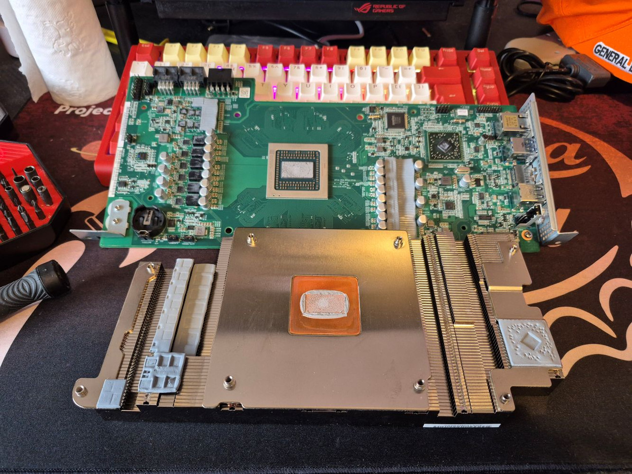

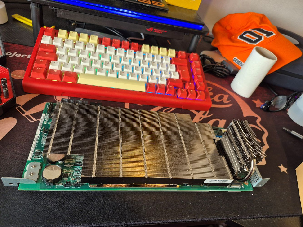

However, yesterday he posted what is, IMO, his most interesting video yet. Basically he got hold of a back plane that was built for mining that contains a Ryzen APU (most specifically the one from the PS5) as well as 16gb memory and etc. IE, a whole PC on a back plane. This.
It is dual slot and about the size of a GPU. Yet, it is an entire computer on a single board. Couple more pics.

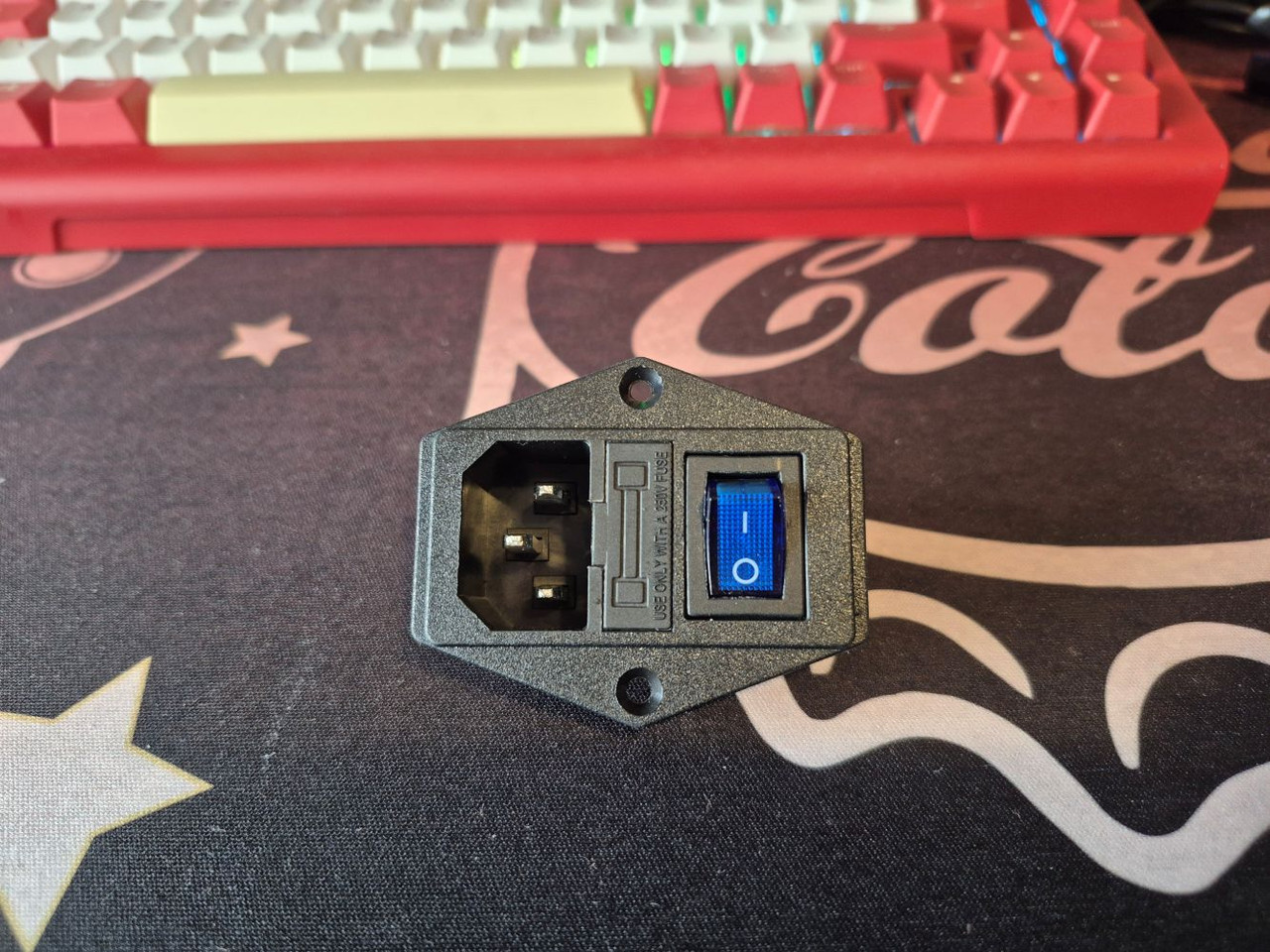

It is a very simple thing to power. You literally just need a PSU. Now I want to keep this thing as small as humanly possible, so I got this.
Now these are known for being noisy. However, I have two options. First one is to put a Noctua fan in it. Which will make it silent. The second option? remove the fan completely. This may sound sketchy, but the design of the unit will be such that it will get tons of air shoved through its bottom just like the plane. How? Well, imagine a PC with a front panel that is, IDK, 130mm x 130mm square. With a nice powerful fan in it. Then imagine the PC being the depth of the back plane so you can connect things to it. This design is also known as the wind tunnel. Which, amazingly, is how the server it once lived in would operate. Hamish stuck a fan to the top of it, but that is not how you would go about cooling it.

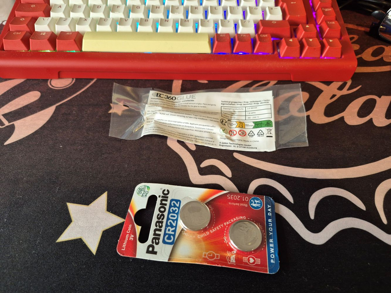

The only other thing purchased is this.
Now you may be wondering what the heck that has to do with anything. Well usually I use a special (and expensive) double sided masking tape called Kipp. It's awesome. However, I usually use old brown card envelopes from that place on the internet you buy crap from. Problem is they can be uneven etc. So I finally decided to buy something suited.
Basically it should be about a mil thick. You double side it down to the bed, and then double side the top to hold down the acrylic. It gives you some breathing space when you go through the acylic without dragging the bit through the spoil board. Which would, over time, reduce the ability to stick things down fully as you would have air channels.
