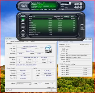

Whoa, cool program.
I posted the temps I get for the Quad Core.
How come the Cores 0# and 2# are at 55C and the 1# and 3# around 44C?
Average temp seems pretty high even with the WC setup...
Just out of interest, what IS the PWN phase 1-4?
I thought those were points along the mobo? Im a noob
It is possible that you are seeing the slightest inbalance in your mount. Try tightening one side, and you might see a temperature change.
Does a dual or quad core cpu have the means to record it`s temps for each core individually ?
If it is the case, does a temp difference of 11 over an inherently small area present an issue in terms of integrity of the pcb as a whole ? (don`t really think so as the materials are `used` to rapid changes in temp with loading-idling, but it`s curious)
This is most likely a larger pressure on one side, touching two cores more, and not two others as much.
