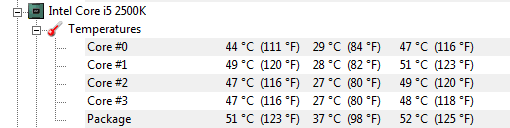

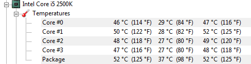

Hey guys,
Just installed my NH-d14 today and just wanted to check over the temps I'm getting at stock. I'm not sure they're correct. I stupidly didn't write down any temps I have from my stock cooler before and just wanted to know what you guys get. I have a fractal design r3 case with the 2 fans that come with it if your wondering what fan setup I have.
Prime 30mins:
Prime 1hour:
Am I just paranoid or are these okay?
If I remember right, a friend of mine with a 2500k and a D14 had around those temps at stock, he thought they were a bit high, but overclocked they didn't rise too much..
Maybe your motherboard just has a bit too much volt on it for stock? Don't know about this on Sandy Bridge, but motherboards do this on X58 all the time..
Think he had around high 40's (48-49) and low 50's on stock with prime, and now he tops on around 60C with a 4.5GHz overclock
Try some overclocking and check the temps overclocked
You using the low noise adapters? Ambient temps? That's the two factors I can think other than mounting it wrong or having too much TIM that affects the temps
Thanks for the info, I'll be overclocking it in a few days. I'm relatively new to overclocking so I'm just reading up on it. And no the fans are at full speed and I'm unable to get the ambient temps.
I ran 38 idle @ stock and 41 load @ stock
but max temps with a 4.5ghz OC has been 61 so far and usually stays around 58

I have the same combo and those temperatures look fine. If you've only just built it, the thermal paste will take a couple of days to settle in and then the temps will drop a degree or 2.

If he is using the noctua stuff it doesn't need to "settle"
