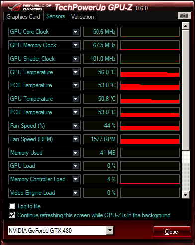

Latest Afterburner and Latest GPU-Z both giving 75c in idle and gpu is correctly downlclocking to 450mhz, I have noticed my vddc doesnt downclock like the core though....
Disconnected 2nd screen and it does downlclocks even further - Significant temp drop also - I am now idling @ 58c... YEYYYYYYY
So all that extra power / heat caused just for having a second screen !!!!!!
Is there anyway I can mod this drivers/bios so I can downclock all the way to 50mhz whilst using a second screen ?
