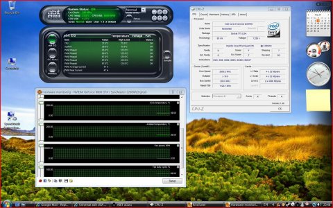

here is my final overclock vcore 1.45 , nb 1.66 , timings 4-4-4 - 10 and stable at 3232 mhz ::D

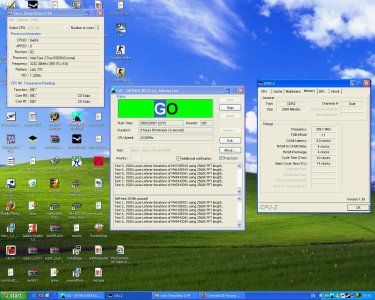

ok so after my stable ocing i am asking are these set , good , these are take under load
get.php
Im a bit wary of using uGuru for temp readings, its always about 10c less than CoreTemp :/
Im currently struggling keeping my system stable at higher clocks, would seem to be a problem with the bios from what i've read elsewhere.
I can have my E4300 at 3ghz without having to push any more volt thru the vCore or the MCH but soon as i start to go above 333FSB i seem to hit a wall :/
I dont think i will see much of an improvement with the extra couple 100Mhz's though.
But it would still be nice to get it to boot at 3.6ghz, will leave it a while though and wait till i get another cooler or go to water cooling.
1st thing , yes that temp which is labeeled cpu in uguru is actually the chipset ,lol i have the same problem i can get 367 * 9 stable but as soon as i put 368*9 it boots but crashes , my vcore is 1.5 and im happy with 44 * c idle and 64 load and my chippy is at 1.65 and it loads @ 60 and sometimes peaks at 65
Are you still using the stock cooler? I've been getting worried about hitting 60c-68c with the stock cooler.
