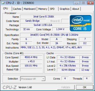

Hello i have already had a post about overclocking my intel core i5 2500k but i have actually managed to achieve a 4.5ghz but i dont like the readings i am getting off of it.
I am getting a reading off of HWMonitor saying that after only a 30min run on prime im getting 78c which in my opinion is too high and should be maximum of around 73c. Also it states that my voltages hit 1.45 which is also way too high. Overclocking on my board is also a pain and i have to work in increments and i can't acutally set a voltage which in my opinion makes it redundant because it never follows the increment i put.
So any help that i can get will be appreciated.
p.s; for cooling i am using the Arctic cooling freezer 7 pro rev 2

Thanks for the support,
My Motherboard is an ASUS P8Z68-V LX and is really getting on my nerves for overclocking. In the bios as i already said there is no possible deffinent o'c and i have to work in increments but it doesn't tell me what voltages i am changing to so it makes it redundant. I decided to try out there Turbo-V software and was able to get a 4.5ghz with a 1.32v that sometimes dipped to 1.3.
I ran intel burn test and it pushed 75c out of the chip (Reading Package). I am going to try and put the same settings from the Turbo-V Into the bios and see the effects.
