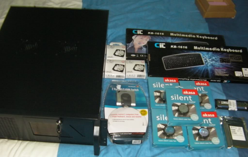

new server
here is another update
some new stuff that just got deliverd yestarday
and my second Server
this case codegen 4u rack mount eco black has 1 120mm fan at the front and 2 80mm fans on the top cover of the case
asrock Mini itx board dual-core 1.60 with 4 threds cpu
4GB DDr 3 1066 Ram
3x 1Tb + 1.5TB Hard drives
400W Corsair PSU
that was the best cabl managiment i could do in this case
videos will be added sumtime soon
