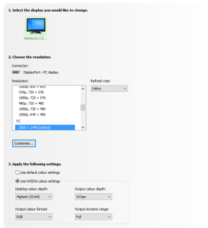

Okay...EVEN MORE PROBLEMS...despite having a 2080 TI I cannot enable 10 Bit color depth at all on the monitor now. Was that also disabled in the Firmware update? Like...why does it feel like this "fix" is giving me so many more problems. Im starting to think I should refund this and get the MSI Monitor as it is finally available for preorder for me. That, or get the LG GN850.

Where are you trying to enable it?
You are using display port 2 right? not display port 1. They are different.
10bit shows up for me ok though.

I factory reset mine and 10bit finally showed up. However, the colors aren't fixed sadly. Still looking slightly washed out(almost like a white film over them is the best way I can describe it.). Im thinking about just preordering the MSI model as it is heavily discounted for preorders. It is going to just be 386 USD so...at this point it feels like the better deal than even this monitor discounted by 200.
