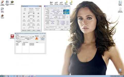

Had a chance to fine tune some of the CPU PLL and SA volts thanks to M&P advice, I am much happier will temp control now :)
