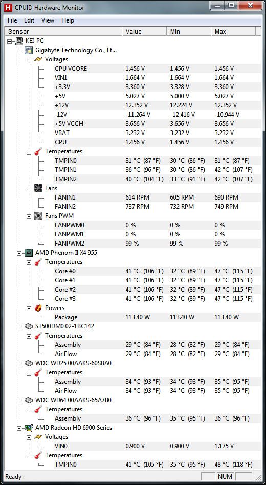

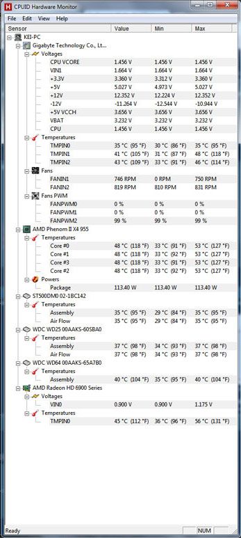

Idle temperatures with two of the case fans off and the one rad fan off and the rest running silently is 37 degrees for the cpu and 41 for the gpu. Not run anything yet but I reckon load temps will be greatly improved.

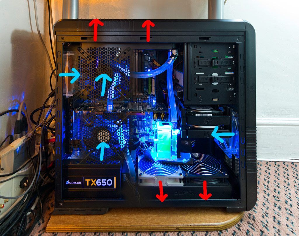

Here are some better photos. The completed loop. You can now see all the connectors on the HDAV H6 daughter board hiding underneath the essence ST. (this is what uses that ugly ribbon cable)
The hidden mess of cables isn't quite as bad as it was before. Lots of green cable ties. (not sure why i chose green but just went with it. Not that you can see any of them) Coolermaster grommets for the holes will be ordered next month.
The aquacomputer aquagratix block is very smart, just wish they did a backplate for the 6970 like the one they have for the 7970.
The alphacool XT45 is a very tight fit up top. With some severe difficulty, i can just about manage to remove the memory without needing to shift the radiator.
