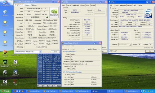

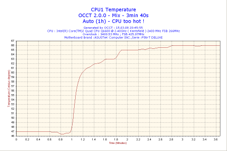

I've fiddled around a bit with OC'ing my rig, and the temps while running my Q6600 @ 3,4GHz is around 46C idle, and almost up to 67C under full load using OCCT (where the program stops testing at 67C). As it is now, I'm only running my CPU at 3,4GHz while benchmarking, as I think the temps are too high. The same goes for 3,2GHz, only with a few degrees lower coretemps, so usually I'm running at 3,0Ghz, where it's @ 40C idle and 66C full load.

That doesn’t seam to bad with air although i am definitely not an expert and have never used a quad on air. I am at 1.45V @ 3.6GHz to run prime stable will boot and run with 1.35 but not prime stable. 40/45 now but in the late sixties after running prime for a couple of hours "Anyone for toast"? And that’s using a PA120.1 + PA120.2 but the GPU & NB are under water as well.

Only thing is more Vcore = more heat :( You should be ok up to 1.4v on the core but i wouldn’t stress test it at that, as your temps are quite high as they are. I don’t like anything over 65c and only over 60 while stressing.
Right if your vcore is set to automatic then your board will have set it pretty high i would have thought. To run 3.4 you should be at about.. 1.38 ide say, 1.4 is pretty high for air.
Your temps do seem orite for air cooling, though i wouldnt like it above 63oc tbh.

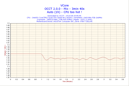

As you see on the attached picture, the vCore is at 1,36v while monitoring, but as soon as the test starts the voltage goes downwards. The ripple is at maximum 0,03 (2,35%). Also, I've read several places that no program reports the actual vCore, but slightly lower?
Have you ever heard of the Vdroop? That is what you are talking about. do a search on the forum or Google "Vdroop".

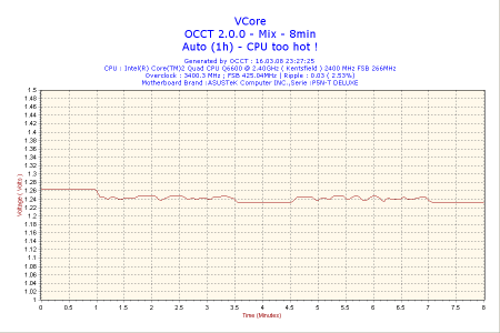

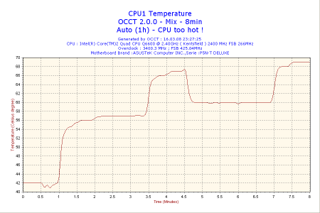

Okay, I tried running it on 3,4GHz at 1,375v on the core, and it managed to keep up with the stresstest of OCCT in 8 minutes before the CPU hit 70C. I don't know if I can call it an improvement, but it's something. :P It's idling at 43C, which is a huge improvement, but it figures if it ran on 1,44v before. ;) I'll try 1,38125v and see if it's more stable. Anyway, thanks for the help this far, guys. :)

Right so now, see how low you can take the Vcore whilst keeping it stress testing.. On air 3.4 is pretty good tbh, though 70c is too hot for everyday use.
Try the vcore around. 1.35 Should manage around 3.2 on 1.35, ide suggest clocking it at 3.2 and leaving it at that.. coz on air, your temps are going to be getting too high.
