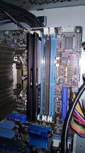

I am having problems running 16GB (4 x 4GB ) of CMX16GX3M4A1333C9 on an Asus P8H67-M PRO <Rev 3.0> motherboard. When I install all 4 sticks I just get the red MemOK light when it boots and does not post. Have tried pressing this and it cycles through a few times but then just goes back and sits on a constant red light.
When I place a single or 2 sticks of RAM in the two left most slots (A1 & A2, blue & black in any configuration) it boots fine (see attached pic). However if I place any stick in the right most slots B1 & B2 I get the red MemOK light. I Know it’s not the RAM as I have used and it is working on another machine.
