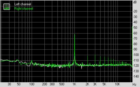

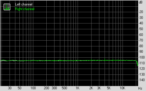

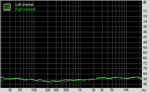

all my measurments not opinions, measured exactly what you want , xxx is marked becouse i cant disclose information on that sound card (cos its not very best as seen by graphs attached) becouse its irelevant.
i put it there just for that you see difference on same graph,for to compare fiio 10 or your mbo audio with this you should have downloaded rightmark audio analyser and make levels to read -5dB, do measurments ,and then we could compare data to see wich one is measuring better.
now i attach noise,dynamic range and crosstalk graphs of creative card alone for simpler readout and if someone else measures their card so its easy to compare, note-measurments are adjusted to -5dB.
btw sorry for going too far but i hate when people try to convince me in stuff i know for 110% its not true.

So you are basing your facts on something you have to hide?
Yup, that makes sense ! This is why I do not take you seriously, because you are posting random pictures of graphs with stuff hidden. Meaning that could be a ten year old sound card you are comparing it to.
Seriously, how do you expect any one to believe that? "Oh here are some random pics with the sound card XXXed out because I can't tell you what it is".

creative soundblaster xfi 5.1 usb,i said few times and its shown on graphs.
standard 44.1kHz 16bit rmaa test.
xxx card is irelevant, look results from last pictures with xfi only ,there is lot of data on those graphs its up to you if you want to read that data or if you want to include tests of your mbo so we can compare ,or continue to ridicule and bend all i say.
measured more than 10dB difference in noise alone between integrated soundcard vs external one, is not 0,1dB or similar that we can argue is it possible to hear or not.
about that louder is not better ,well it is not but if its same level of noise ,card that do 3dB louder will have 3dB more dynamic range so actualy it is little better.

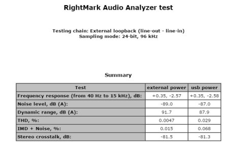

usb3 specs are more data lines on higher frequency and higher current rating on 5V rail. exactly same shielding.read this why is that bad and shouldnt be done that way but they wanted to get some compatibility so this are consequeces.it it has same shielding as 2.0.
you say believe me , i say ok will do but only when you measure stx II and give me way to compare noise profiles with those of external card posted here.
Oh give it a rest, there's a whole research field in electronics for smoothing out power lines and inteferences and blocking EMI from getting to the electronic components, that why the expensive sound cards have that metal shield around them, that's why in the power input there are a lot of coils and capacitors. Now regarding the usb outputs Schiit makes this http://schiit.com/products/wyrd and they MENTION it down below that they don't believe that removing any interference from a usb signal is going to do you noticeable difference...
i hope this is not reply to my post before.
becouse it would be sooo wrong trying to proove me wrong with device that for only 99$ is providing regulated 5V output and is called usb decrapifier literaly.
edit , as i also own schiit modi dac when wyrd first come i made my own wyrd and measured it , in attached picture are results. truth be told i never used it after that testing becouse of too low improovements but improvements are there.
