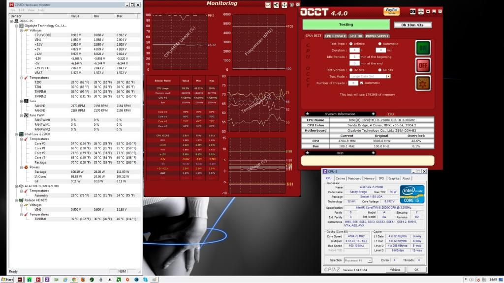

2500k, is this voltage normal for 4.6GHZ?

Do you have speedstep enabled? That's most likely the voltage when not underload and downclocked by speedstep. Run prime 95 and then check your voltage in CPU-Z.

Show prime 95 or OCCT running when you take the screen shot, that just sounds like speedstep kicking in at idle.
thanks for the replys, the cpuz i verified and linked was while prime95 was running. I will get a screenshot for you now. and just to say the bios is where i have set the voltage.

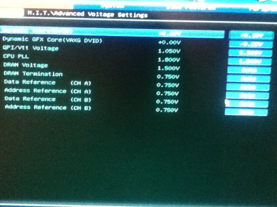

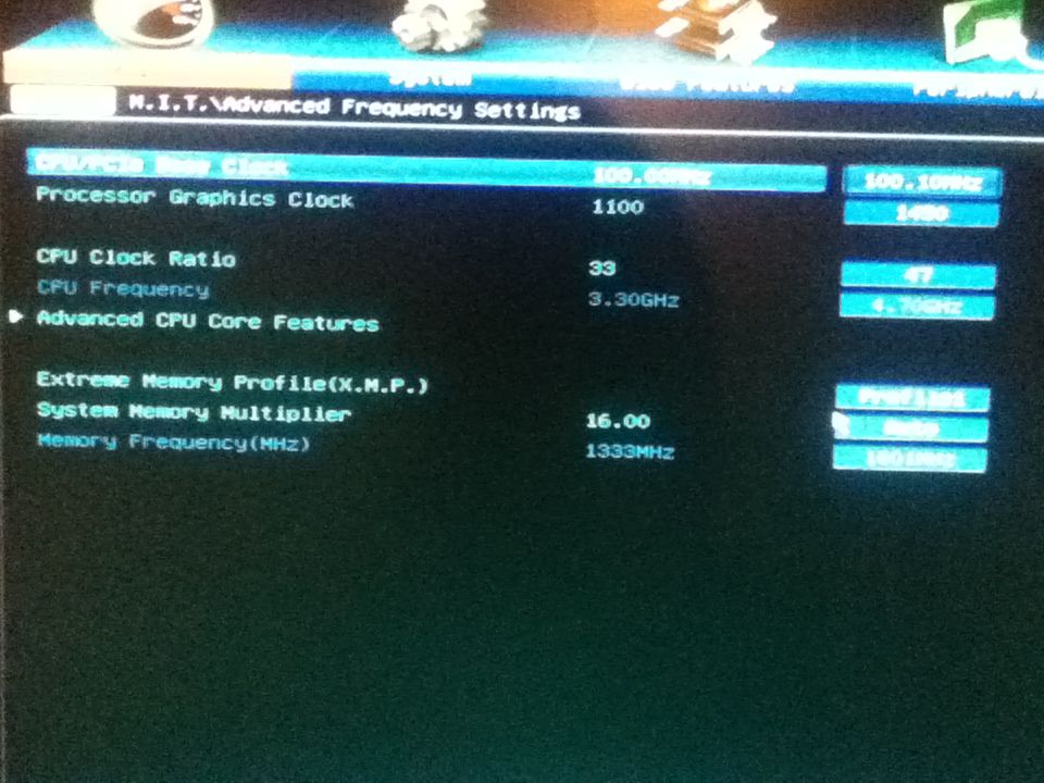

Are you running an up to date version of CPU-Z? Can you post a screenshot of your BIOS settings as well.

yes i had to update it so i can validate the check. and HW monitor is giving me the same voltage and the bios is the same. oh just realisedthat that screenshot i have just done and (i am still currently running) is at 4.7ghz if nobody noticed :)
Something is not right, there is no way a 2500k could do a overclock like that at stock volts. Some of the most highly binned 2500ks need at least 1.25v for 4.5ghz.

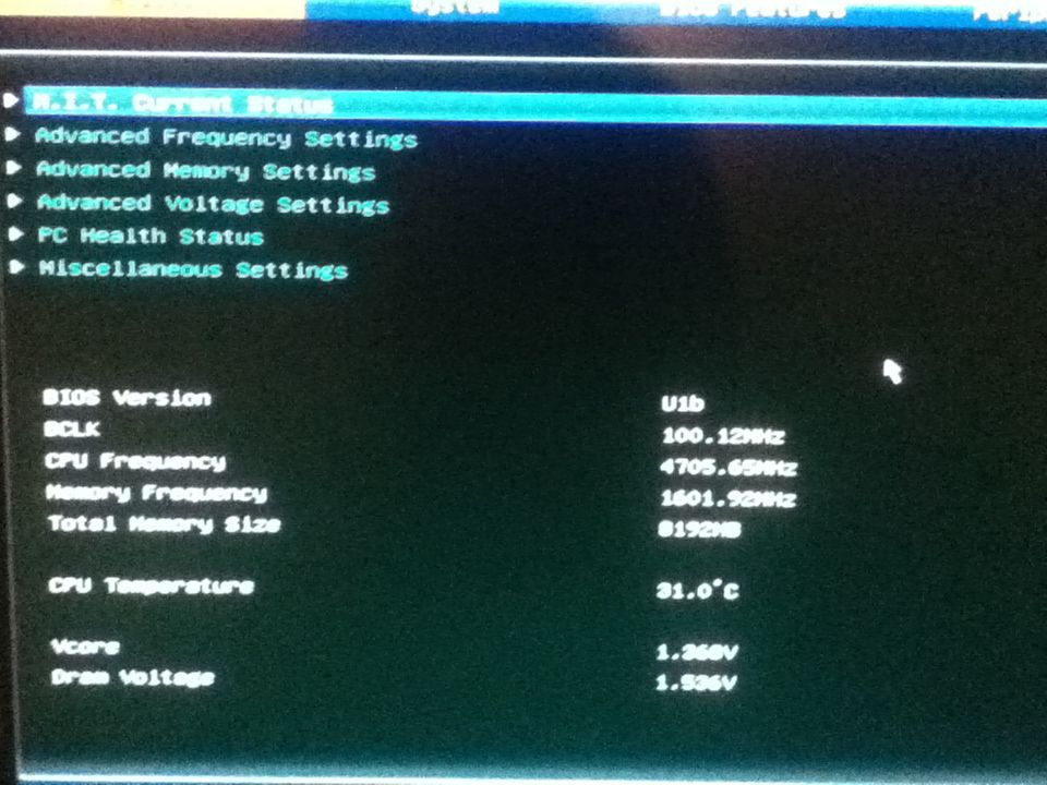

According to your BIOS you CPU is running at 1.36v (shown in the last pic) which makes more sense.
