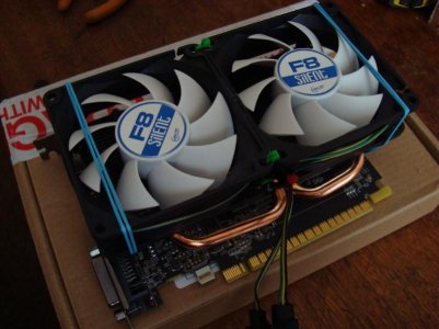

48 degrees of load temperature is insane – no card needs to be this cold. My first attempt at a mod was to put a resistor in front of each of the fans, which are “blind” controlled by a DC voltage from the board. No PWM, no speed sense. Sadly the fans’ absolute minimum running voltage was still too loud and added an infuriating clicking from the bearings. Pity – it still looked stock.
Take 2 used two Arctic Silent 8’s from eBay for less than eight quid running at a fixed speed from a board header. Dialled down below the case ambient noise and the load temps now read… 48!

Addendum – cooling mod
