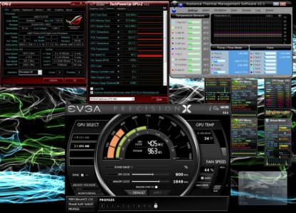

your telling me that my temp reading 23C into my CPU and 28C out is NOT heating up my water that fast?? AT 3 LITERS a MIN....
Please sir explain that to me
Question: This is 23C into the CPU block, 28C out of the CPU block, not 23C around first manifold, 28C around second manifold (just to be sure
