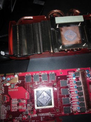

I recently bought a VTX3D Radeon HD 6970 X-edition to put in Crossfire with my current sapphire reference design 6970.
The card out of the box had quite a high OC of 940/1425 rather than stock 880/1375
The card was very unstable out of the box once it got put under anyload instant blue-screen. I have since flashed the 2nd Bios to stock frequencies and the card works fine. I then realised that it was running extremely hot. 105degrees C when my reference design cooler on the sapphire was maxing out at about 80Degrees.
The VTX3D card has a dual fan cooler that looks very similar to the twin frozrII.
I then removed the cooler and for that it had more thermal paster then it did cooler (I exaggerate) but a lot of thermal paste. After re-applying a realistic amount of thermal paste it now is down to 80 again.
I do realise that I did buy a cheap brand but I would assume that if it came out of the factory Overclocked it wouldn't have Cooling problems and would be stable.
I have not put the clocks back up since I re-applied the Thermal Paste on the cooler.
Has anybody else had issues with factory OC Graphics cards?
If so what?

th paste looks fresh but whoever applied it should not do it again.
try with turning volts down, so the card runs cooler also a after market cooler would not only look better but perform better and quiter
@Pr3d4t0r: When I took the cooler off I was like WTF Happened here. It was like somebody went to put the thermal paste on then somebody walked up behind them and scared the crap out of them, they jumped and pushed the plunger right down. xD

Tis a stupid amount of thermal paste used in the factory
