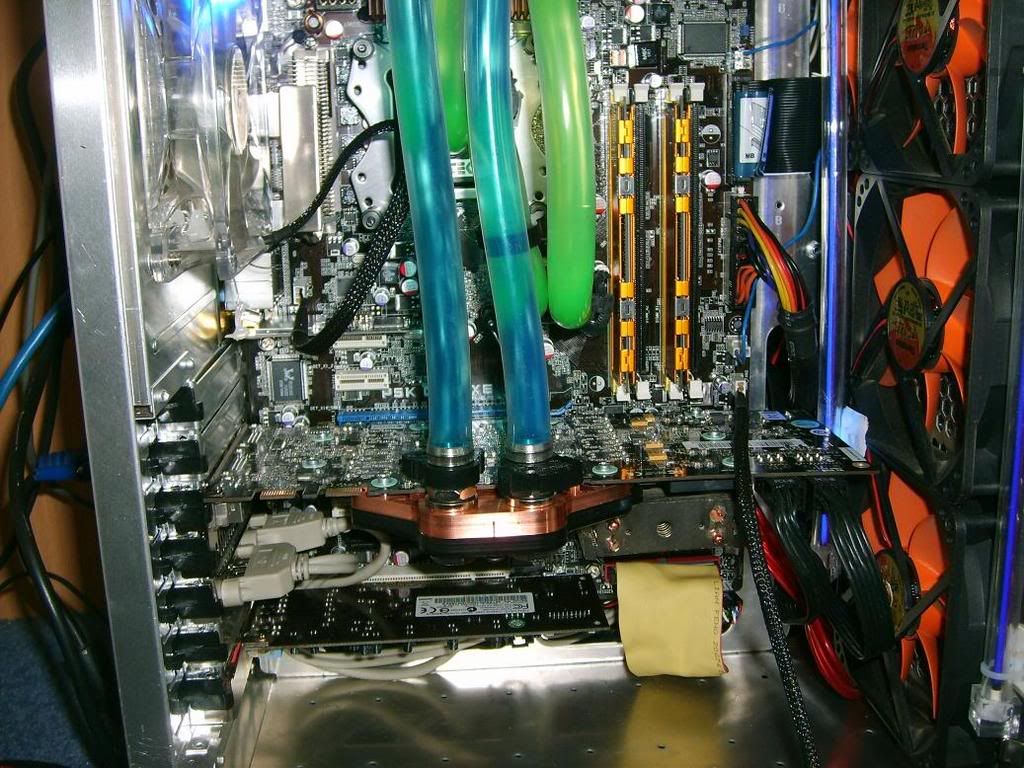

i have one fitted to an asus p5k deluxe using the big side and one of tyhe push pins then a tie wrap going fromt he hole in the board around the coler pope and back through the pin hole and that side is tighter to the board than the push pins are
like this you cant see the tie wrap very well but thats a good thing
excuse the fan lighting im in the middle of changing the led's to uv ones

well.........i did get it fitted.....and its FACKING HOT!!!!!!!!!
not very good pictures, but you get the idea......
before i fitted this bling bling to replace the standard ones, e.g. Asus crap pipe, it never was 'hot' to my touch, even tho i had the board running 1.5v@3.6Ghz.......
i have to say this tho.......if you have a Commando board, i would HIGHLY recommend this bling bling to replace the crap pipe that came with it....
read this :- http://www.thermalright.com/a_page/main_support_hr09.htm
before you give me crap saying they are a lying bunch of money grabber.......no, what thermalright put in that FAQ is true, tho, i only have a Commando board.
the crap pipe from Asus, only have contact with 4 mosfet on my board, but i have 8?!
after a bit of fiddling about, i've managed to get this bling bling to cover 6, not 8, but better than crap pipe.
you can, however, cover all 8, with a bit of modding, ie, dremel.......
