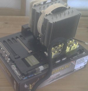

Well...all parts arrived. Started putting it together out of the case to make sure everything worked...nothing! Strange I thought. I decidee to take it apart and put it in the case, perhaps I missed something.
Connected everything up, nothing! Checked all connections and still nothing.
I decided to disconnect my psu and try it in the build, worked first time
The New PSU (Corsair AX850 Gold) is knackered. RMAing it.

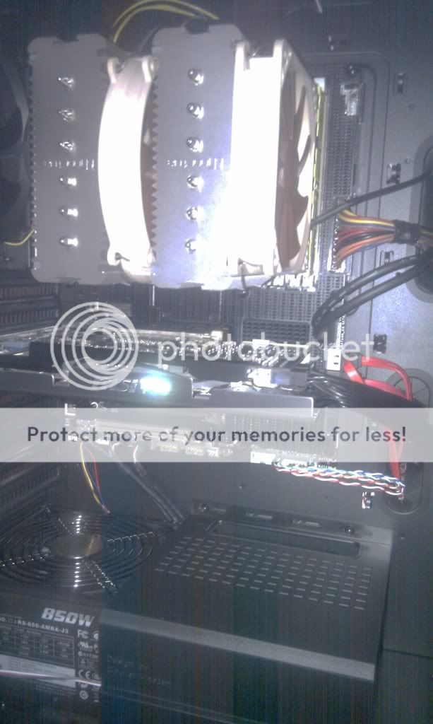

Is the Noctua facing right way, or will I need to swap fans round? lol
Thx

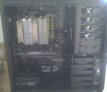

Need more help!
As you can see, the 1TB HDD is recognised in the Device Manager but I cannot see it on My Computer.
Any thoughts? lol

Quick thaught. Dont you want the hot air to go out at the back of the case(exaust). Looks like the fans airflow goes towards the 5.25" bays?
