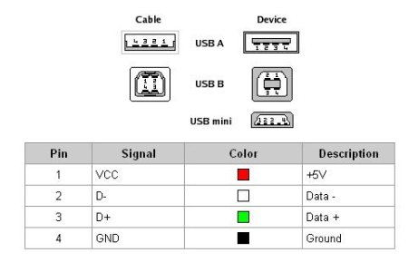

Oh boy are you gonna have some fun with this! Especially trying to keep the "Simple" 5v regulated over a split single socket.
