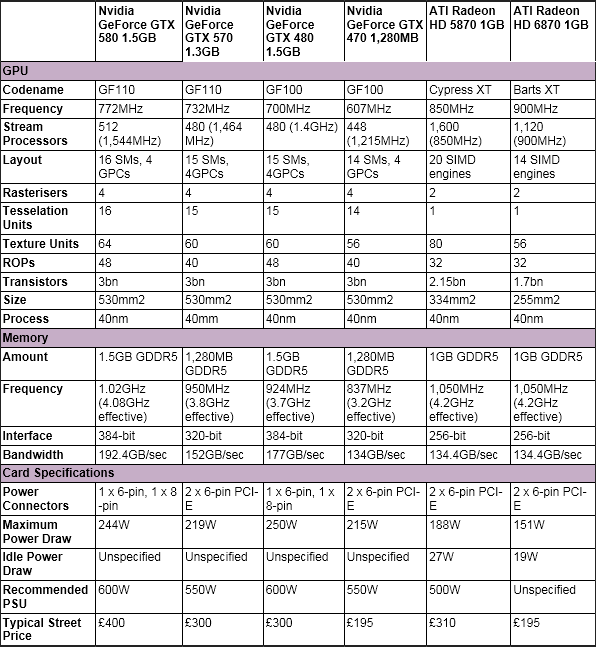

what clocks do you have to use to get a gtx480 to run at the same performance as a stock gtx580 ? , i want to know cause i would like to see if it is worth buying one for my system

I would guess around 820core and 1650mem on the 480 would evenly match up to the 580.
GTX480
  • Chipset Manufacturer: NVIDIA
  • Core Clock: 700MHz
  • Shader Clock: 1401MHz
  • Stream Processors: 480 Processor Cores
GTX580
  • Core Clock: 772MHz
  • Shader Clock: 1544MHz
  • Stream Processors: 512 Processor Cores
matching vlock to clock and shadar to shader will even out the performance but the extra cores on the 580 will still blow the 480 away in some benches and fps. Also add to the fact that you'll have to pump the voltages a bit to make the 480 match the 580 clocks and shader you'll also increase the temps of the already warm to hot 480 the 500 series cards have already proven to be alot cooler even when oc'd

You can make your 480 a 570 clock for clock, as they're essentially the same in all but name and cooler.
Be interesting to know what %age oc you need to get to match a 580 performance tho. Logic would suggest 6-7% more. Run a 580 at stock-stock 772 and a 480 at 826 ish would carry that suggestion.
