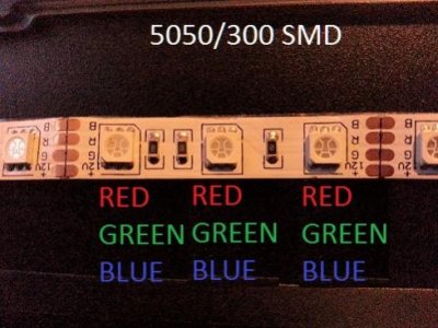

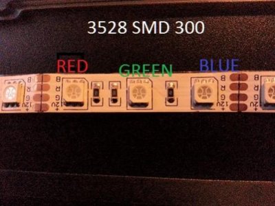

hello well first of all i don't have both 3582 and the 5050 but you will get the point hopefully that I'm trying to make.
I use the 5050/300 the 300 stand for 300led in 5 mtr length you can also get 150 but it wont make much difference but the 300 will give you a more even coverage and will use a little more wattage.
If you want to just your side panel you will not need anymore that about 2-3 mtr's and at the mo im using about 2 mtrs for a corsair 750d and it uses about 24 watts with white setting on maximum brightness
take a look at the pics
3528 has 1 of each color
the problem is the color does not mix properly in close pleases ie if you want purple you will be able so see red and blue in separate colors
now look at the 5050 smd
each smd has all 3 colors in and mixes the colors much better

so you will be best getting 5050/300 with a 44key remote and 5amp power supply
(to run it from mains)
you can mod a 4 pin molex to 3 pin fan cable for it to run off you psu but you will have to have some knowledge with a soldering iron
its a long one but hope this answers your question
