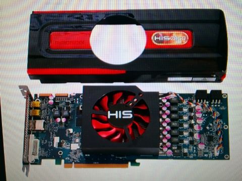

I've manged to find out that the HIS 7950 has a reference pcb . But I need a little help on the block choice . I'm looking at the Alphacool ATXP full cover block . The problem comes is they do 2 versions a rev 1 and a rev 2 the rev 1 has a small cut out for the vrm where as the rev 2 has a hollow and built up area for the vrm to fit under . Looking at the pcb it doesn't have a single row of capacitors , it has a double stagared row . So to my mind I would need the rev 2 . Not sure if that makes sense to you so here are a couple of pics .

I personally would say Type 2.
I had VRM heat issues at the Alphacool ATXP rev 1 because of no active cooling for the VRM's.
GPU stays cool but the VRM's ramping up to 100°+ C.
I Changed to Aquacomputer with a max of 39° C GPU and 42° C VRM's.

Your card looks like 7950 reference should be Type 2.

Your HIS Card has is exectly the same as my 7950 from sapphire... Just the plastic shroud around the fan is different..
My vrms get up to 100c at 1100mhz, let me know how the cooling goes for you, I may have to do the same...
Edit.......
According to this thread we have rev 2 pcb http://www.xtremesystems.org/forums/showthread.php?282629-MSI-TwinFrozr-HD-7950-Experiments

Cheers mate. That's lucky I have just put the order in for the rev 2 , and the card . Looking at the blocks the rev 2 was obvious really . On the rev 1, it only has a small cut out slot for a single row of caps. Whereas the rev 2, has a bigger kinda machined out bit . Other than the vrm's getting hot, what was the actual gpu cooling like ?
