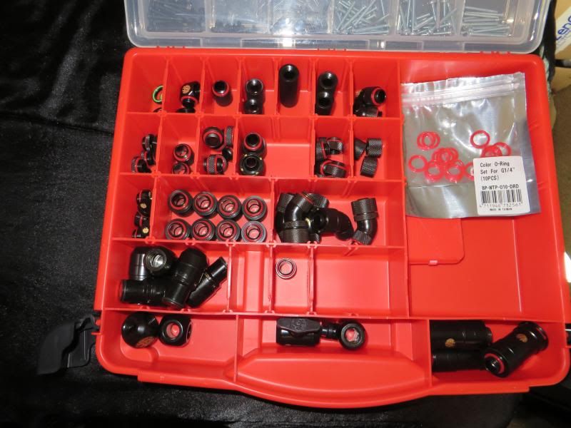

P.S. I'm using regular tubing, not acrylic, but i do have a pretty good bend radius with the primochill advanced LRT, that and i have a boatload of fittings. if this helps here's the fittings to help plan it, i do have more 90/45/30 and straight fittings, they just aren't in the picture, if that can help also.
